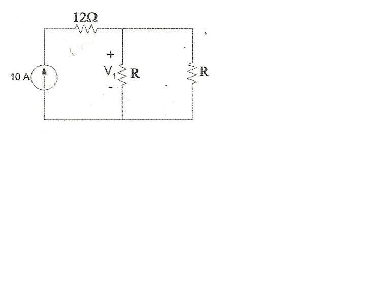

I have to find the value of R
v1 = 30V
this is how i did it
since R is in parrallel i juts put that R/2
R/2 = 30V/10A = 3ohms/2 = 1.5ohms
is this correct?
noname1 said:
R/2 = 30V/10A =
Try it again, multiplying both sides by 2.
Calculating (using valid maths) is probably better, but think about how the current will split through each branch given equal resistance.
Then use Ohms Law.
