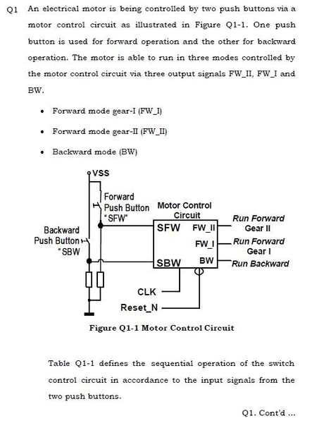

Ok so I just want to see if my idea for the state diagram seems ok, I'm going to give it in table form here but its the same info.
Code:
F  |  Bk  |  A  |  B  |  C  |  D
0  |  0  |  A   |  B  |  C  |  D
0  |  1  |  D   |  A  |  A  |  D
1  |  0  |  B   |  C  |  C  |  A
The F is the forward button, the Bk the back button. A is the stop state, B is the forward state 1, C is the forward state 2, D is the backward state. I then put this into a state diagram with the 3 possible changes/inputs for each state. However should I have included the clock and the reset button in this? So that there would be 16 possible inputs?
