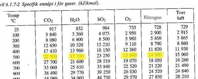

With the molar-% (or volume-%) known I can use the same equation as above to find the enthalphy on molar basis (see the attached file for the table from where I got the enthalpies) :
##h_{fg}=\frac{v_{CO_{2}}h_{CO_{2}}+v_{H_{2}O}h_{H_{2}O}+v_{N_{2}}h_{N_{2}}+v_{O_{2}}h_{O_{2}}}{v_{CO_{2}}+v_{H_{2}O}+v_{N_{2}}+v_{O_{2}}}=
\frac{8\%\cdot 22347\frac{kJ}{kmol}+8\%\cdot 17617\frac{kJ}{kmol}+72\%\cdot 14808\frac{kJ}{kmol}+11\%\cdot 15580\frac{kJ}{kmol}}{100\%}=
15999\frac{kJ}{kmol}##

I think your methodology in post #5 is correct. However, I am concerned that the specific enthalpies of all the gases in your table are taken to be zero at 0 C. Shouldn't the heats of formation of H2O and CO2 be included?
Chet
