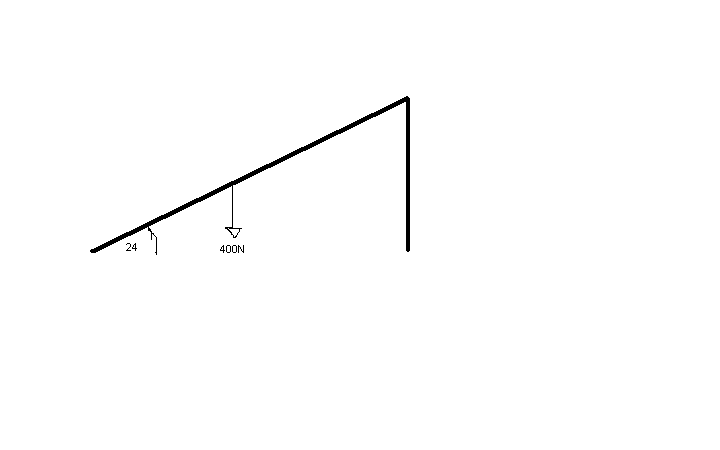

I need to find the component of W (the 400N force) that is parallel to the slide as in the attached picture. As you can see there is a 24 degree angle between the surface and ground.
I should be using simple trigonometry. The equation I am looking for is 400cos66 (or the appropriate version of sin) to give me an answer of 163N. So any help on how to find the triangle that would help me solve this problem would be appreciated.

Seems that you already know that the parallel component is [itex]W\cos66[/itex] (which is the same as [itex]W\sin24[/itex]). So what do you need a triangle for?
Check this out: http://www.glenbrook.k12.il.us/gbssci/Phys/Class/vectors/u3l3e.html"
I think he knows it but doesn't know why
You have that 400 N force going down, break it into the two components, one is the component parallel to the incline, one is the component perpendicular to the incline(going down and to the right, of course)
Do you remember how to add vectors pictorally? Like so
http://liftoff.msfc.nasa.gov/academy/rocket_sci/orbmech/vector_math.gif
for example. Arrange the three vectors so that you have the x component plus the y componet equals the 400 N force going down, and you'll see how you can use trig to solve for the two components magnitudes
EDIT: As you know the answer this trick doesn't help you, but if you ever forget which to use, sin or cos(using the given actual angle, not the complement like you did, ie 24 instead of 66)
If the angle were 0, as in it was just flat, there'd be no component going down the incline(as there would be no incline)it'd all be going straight down, so the correct trig function should equal 0 when the angle is 0, which sin does.
Similarly if you want the component going straight down, it would equal 400 N when the angle was 0, which corresponds with cosine.
