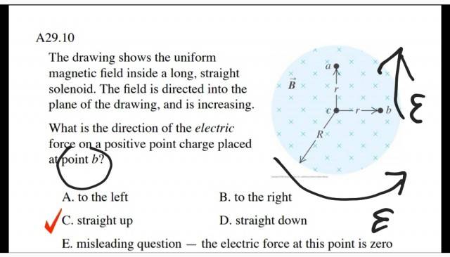

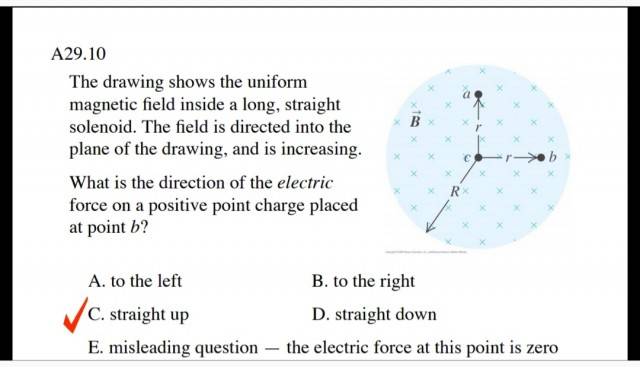

Since i only know the field direction, increasing go into page. Why the answer is C?
[ATTACH=full]226152[/ATTACH]

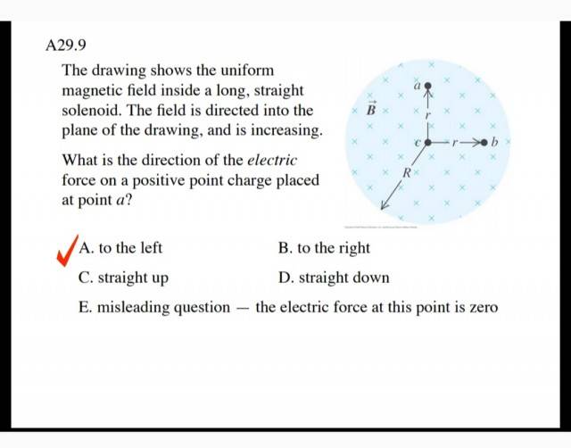

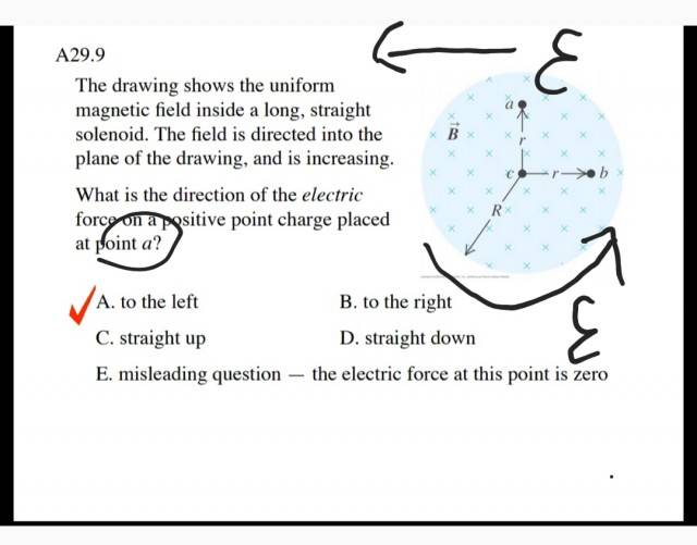

Why the answer "a" ?
The R and r on the pic is respected to what?

The key word here in the statement of the problem is "increasing" and they should say "increasing with time". The question involves the Faraday EMF that occurs. The changing magnetic flux creates an EMF. They basically are asking the direction of the induced ## E ## of the EMF.

Could it be like this?
Force direction the same as Emf's ?

That is correct. The EMF is the integral of an induced electric field along the path. The electric field ## \vec{E}=\vec{E}_{induced} ## is what the positive charge responds to, and experiences a force ## \vec{F}=q(\vec{E}+\vec{v} \times \vec{B}) ##. ## \\ ## (And of course, when they say "placed at point b", etc. that means ## \vec{v}=0 ## so that ## \vec{v} \times \vec{B}=0 ## ).
