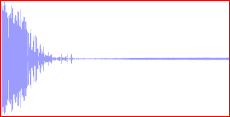

Thank you for your response, berkeman. I see what you're saying. Is it not at all appropriate to consider a sound wave to act on a object like a compressed air pulse would? I was hoping to be able to simulate the effect of a gunshot-type noise by exerting a force to the object but does that just not make sense, physically?
berkeman said:
It is an oscillating longitudinal wave. A single gunshot would look something like this (you can see the decaying oscillations):
http://www.flashkit.com/imagesvr_ce...shot-Farbod_A-8301/gun_shot-Farbod_A-8301.png
To get more of a pulse, you should look into the subject of Blast Waves. @Dr. Courtney is our local expert on blast waves.
