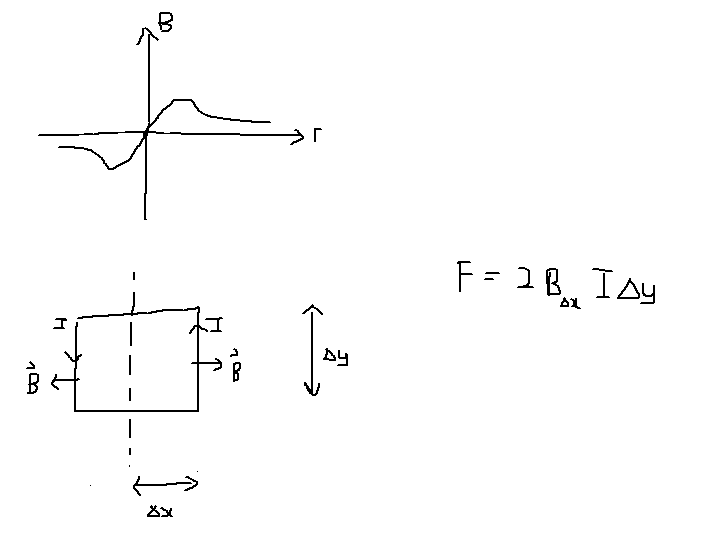

What is the force on a magnetic dipole in a coil at r = 0?
In summary, the conversation discusses the relationship between potential energy and force in the context of a dipole in a magnetic field. It is mentioned that the force can be found using the negative gradient of potential energy, and that there is also a radially inward field present off the axis of the Maxwell loops. The conversation also addresses a question about finding the force at r=0.
unscientific
1,734
I found dB/dr to be constant near r = 0, so it's a straight line, implying B increases linearly with r near r = 0.
For the second part, I assume the setup is as such, if not placing the dipole with its axis parallel to the coil would make B = 0, and hence no force at all..Not sure what energy has to do in this case.
There is a relationship between potential energy and force.
Sounds good.
[Edited to correct a misstatement] Although there is only an r-component of field on the axis of the Maxwell loops (r-axis), off the axis there will be a radially inward field (perpendicular to the r-axis and toward the r-axis). A dipole in the form of a small current loop would experience a force due to this radially inward field.
But, it's easier to find the force by using the idea that force is the negative gradient of potential energy: F = -∇E. See if you can use this to find the force. [I see MisterX posted this suggestion before me. Sorry.]
TSny said:
Sounds good.
Then, wouldn't the force simply be F = - ∂U/∂r = m ∂Bext/∂r at r = 0?
This is simply the earlier part of the question of finding ∂B/∂r at r = 0.
Yes, that's right.
