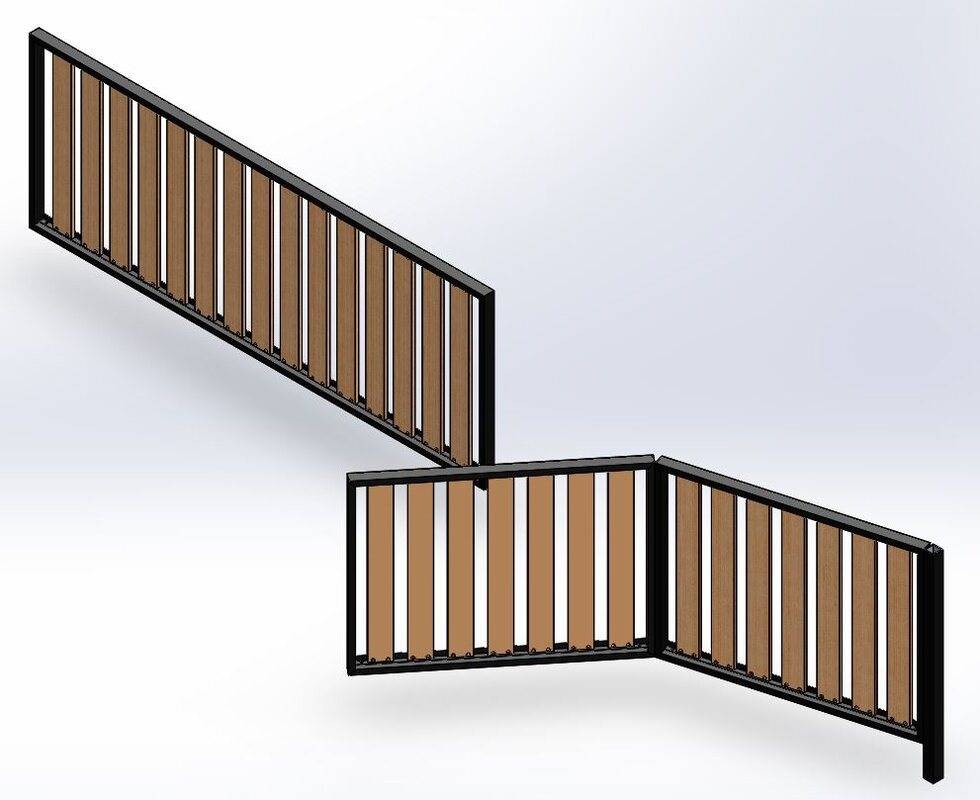

I have attached the first iteration drawing. The gate on the right will be the one with the actuator and the bracket will be attached to the thick post on the far right. Ignore the fold in that gate. It is bifold and teh second section of that gate will be mounted on self close hinges, but it is all part of the same gate. The larger gate to the left will be a sliding gate.

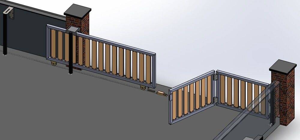

The second image is a newer iteration and gives a better idea of what I am doing.

Goz83 said:
The actuator motor section is supposed to be very close to the gate hinges.
I don't believe that is optimum, or even possible.
Unfortunately there is no plan showing the actuator mounting layout.
I will look into the mounting geometry needed for { 600 mm to 900 mm } and 90 deg.

I could distance the actuator about 100mm from the hinge if need be. This would widen the base of the triangle.
The actuator has a length of 600 to 900 mm.
Allow ±10 mm at each end for wear, flexing, and errors in construction.
Use as much actuator movement as is available; 610 to 890 = 280 mm.
If you need less movement, use a shorter actuator.
There will be a pin on the gate, some distance from the hinge.
The gate will swing through 90°, and move that pin through 280 mm.
The distance of that gate pin from the hinge axis will be; 280 mm / √2 = 198.0 mm.
If the right angle triangle is symmetrical, the actuator will exert the same force, and have the same speed at both ends of the movement. The actuator will then lie on a line 45° beyond the open gate.
Now place the gate pin on an offset from the gate. That rotates the diagram and brings the fixed end of the actuator closer to the wall, (NOT to the hinge). I believe the offset and pin position will be about 198 mm / √2 = 280 / 2 = 140 mm. The offset will depend on the position of the fixed end of the actuator, close against the wall. But the gate pin will remain 198 mm from the hinge pin.
