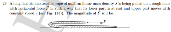

Suppose length of upper portion is ##x## and that of lower portion is ##L-x## .
In time ##dt## , ##dm## mass of rope starts moving abruptly with speed ##v## .
The kinetic friction acting on the upper part of the rope is ##f = \mu M(x)g## , where M(x) = Mx/L .
dx = Mdx/L
Applying impulse momentum theorem ,
##(F-\mu \lambda xg)dt = (m+dm)(v) - mv##
##(F-\mu \lambda xg)dt = vdm##
I don't know how to proceed from here .
I would appreciate if someone could guide me .
Thanks

Forget kinetic friction. You know that
$$F=\frac{dp}{dt}=M\frac{dv}{dt}+v\frac{dM}{dt}$$
Find ##dv/dt##.
Find an expression for ##M## (moving mass) as a function of time then take the derivative.
Substitute.

Please confirm one thing .Is the upper moving part of the rope sliding on the surface or is it in air ?
The picture you posted shows that it is in air.
Alright . Thanks . I was assuming upper part to be sliding on the rough surface .
If the upper part of rope is in air , then from the OP , I can put friction f=0 and F = vdm/dt = λv2 , i.e option b) ?
Yes.

According to answer key correct option is c) :eek:
I saw the same question in another book . It also suggests answer is option c) .
Clearly you cannot support the rope in the air like that, but I do believe you are supposed to neglect kinetic friction.
Option c is only correct if the work-energy theorem applies rather than momentum conservation, but I would say this is a typical case where it would not (essentially you have inelastic collision of the moving rope and the part that starts to move). I would go with b.

I got option c using momentum. Certainly work conservation should not be assumed.
In time t, the leading end of the rope advaces by vt and the fold advances by vt/2. This means that a length of rope vt/2, previously stationary, is now moving at speed v. All other sections of rope are at unchanged velocities. The change in momentum is λv2t/2.
How did you infer the distance moved by the fold ?
I understand that when the leading end moves by vt , vt/2 amount of rope from top and vt/2 from bottom starts moving , but essentially the mass that has moved is λvt .

No, it is not. When ##vt## is equal to the length of the rope, only half the rope has started moving - the other half is still at rest.

If at time 0 we label the point on the rope at the fold as A, at time t A has moved vt to the right. But the new fold, as a point on the table, is vt/2 from where the old fold was, so the extra length in motion is from the new fold to A, a distance vt/2.

When rope end moves from F to F' by distance z , fold moves from A to A' by distance z/2 . OK till here .
But in the process doesn't part CD (from top) and part EG (from bottom) move by distance z/2 each .In effect z length of rope moves o_O

Yes, but CD was already in motion and has not changed velocity. All the momentum change is in EG.
