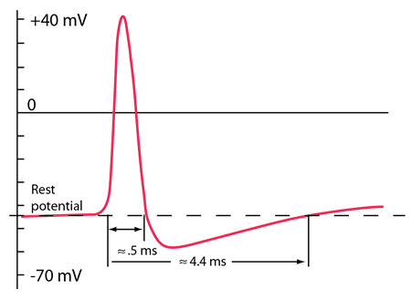

Can someone help me figure out a formula for an action potential of a neuron? (attached)
I want to find a formula for an action potential (illustrated with the curve in the attachment). I would like to use the formula to graph this in Desmos graphics calculator. I don't have much of a math background, but a sine function comes to mind...I would like to get the precise shape though. See the source of the image here (top figure).

It doesn't look like any standard, closed-form, equation to me. What accuracy are you looking for? There are interpolation methods that can give a reasonable approximation, but they are messier than you might want.
Likes benorin and mfb
The difference of two exponentials can look roughly like that. Example: 6*exp(-x^2*36)-exp(-(x-0.4)^2)
To model the tail better a Crystal Ball function can be used.
sin(x)/x could be interesting, too.
But generally you won't get a really good approximations just with random functions unless you add an absurd amount of parameters.
Likes WWGD, benorin, dextercioby and 1 other person
Just eyeballing it, it might be possible to approximate it with the sum of a normal distribution and a piecewise continuous function like
\begin{equation*}
g(x)=\begin{cases}
0 \quad &\text{if} \, x \lt a_1 \\
a_2-(x-a_3)/a_4 \quad &\text{otherwise} \\
\end{cases}
\end{equation*}
Where the parameters ##a_1##, ##a_2##, ##a_3##, and ##a_4## are TBD.

This looks similar to a 2nd order band-pass filter step response, as shown below. The parameter Q will adjust how oscillatory the curve is. The parameter ωo is just a scaling factor for time.
Likes Delta2
The longer negative tail in your picture is a more nonlinear response. Probably best done in some piecewise approach. For example, the previous function where ωo is larger when the signal goes negative.
All of the above are very interesting, but it turns out I will need a more precise solution. I have been trying out different variations of mfp's formula 6*exp(-x^2*36)-exp(-(x-0.4)^2). I chose that one because it is easy to use in Excel. (I realize that some of you came up with more precise ones, but they were more difficult to use). So I was trying to modify it, but after many tries I was still unable to get a largely symmetrical curve with a *flat left tail and *an undershoot following the fall of the curve followed by a small rise to the original baseline level. The precise shape is important - if my description above is not clear enough, you can check the shape here. It would be good to to get key values right. That includes - 70 mv for the baseline (i.e., resting potential), +40 mV for the peak (action potential), -80 mV for the undershoot (hyperpolarization), then followed by return to baseline (around - 70 mV). I will continue working on this, though as I mentioned I don't have much of a math background. So this may take a while :) I would be so grateful if someone could kindly help me modify the above formula to get the precise shape and the values: -70 mv, + 40 mv, -80 mV followed by -70 mv. Many thanks!
You can't expect the shortest formulas to give the best approximations. The more complicated the function the better it can be tuned to your specific shape, generally.
Adding a baseline and making the amplitudes free parameters:
a + b*exp(-x^2*36) + c*exp(-(x-0.4)^2).
Far away from the peaks the exponentials evaluate to zero, so you can subtract 70 to get the baseline right: a=-70
The two exponentials have the maximum very close to 0 and the minimum close to 0.4.
At x=0.4 the first exponential term is exp(-5.76), i.e. it's negligible. The second one is just 1. To get the negative peak height right we need a+c = -80, i.e. c=-10.
At x=0 the first exponential term is just 1 and the second one is exp(-0.16). To get the peak height right we need a+b+exp(-0.16)c = 40 which leads to b = 118.
New plot
There is one additional degree of freedom: The offset of the second exponential - or alternatively the width of the first one. That determines how far the second exponential leaks into the first one.
Example with larger separation
-70 and -10 can stay the same, the 113 is the result of the updated calculation following the approach above.

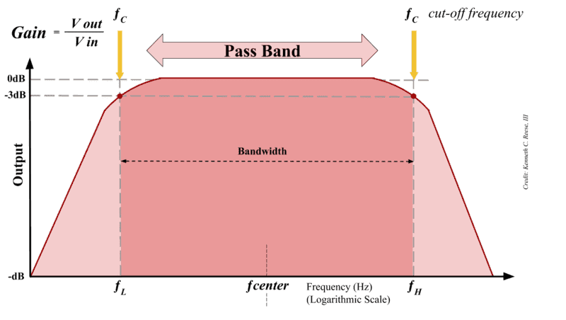

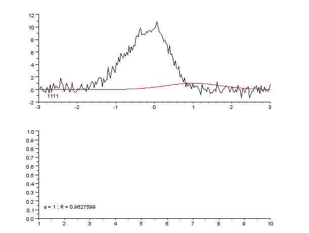

Why do we approximate? Why shouldn't we be precise?
Are we trying to be precise by using the methods?
Band-pass filter comes to my mind.
The filter removes noise.
The other curve is being approximated?
