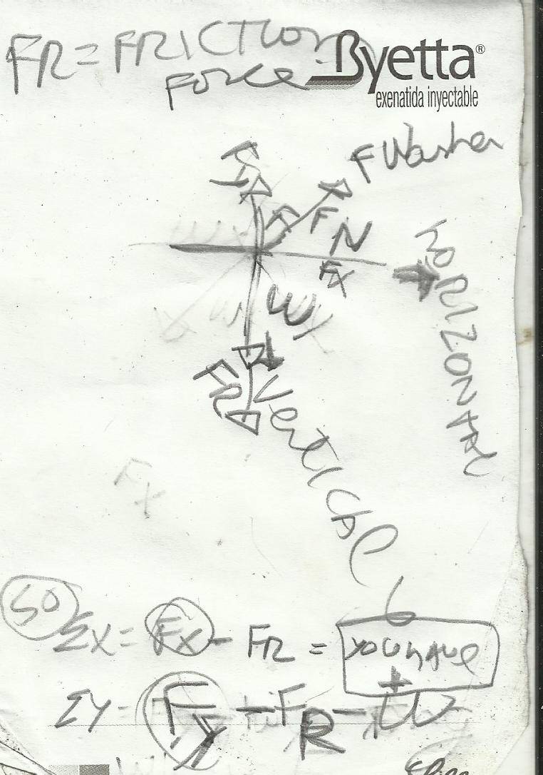

SOLVE THIS PROBLEM View attachment 3071
And this is the figure View attachment 3072
I need the free body diagram because the book solve this problem in this way
the force normsl is n = fcosx
the verticall componente is fsenx = w + miuN
why does the fr is vertical in this case?

Yeah I want the drawing or the plot of the free body diagram of the problem That is I required or asked
Okay! What do you have on your free body diagram so far? :confused:
\partial \nabla
Here you are my free body diagram as you see we disagree in x axe because you have f cos53 - fr
The book says that fr must be in the vertical
accordin to book in the horizontal there is only one force f cos53 View attachment 3117
What are you defining "Fr" to be?
Your textbook isn't in disagreement to what I've said.
I said:
$F_x=F_{bx}-F_N$
$F_x$= zero:
$F(\cos\left({53.1^{\circ}}\right)-F_N=0$
So it simplifies to:
$F_N=F(\cos\left({53.1^{\circ}}\right))$
That is what you have in your first post.
I think you are referring to frictional force with $F_r$. I used $F_f$ instead. Your free body looks correct, and our equations are in agreement. We just used different variables :D
