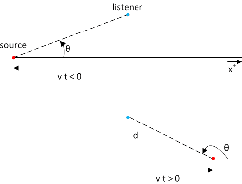

Aren't you making life difficult ? In the first one I miss a square (v-vs2√...) , in the second I miss the brackets around the numerator and in the and third I miss the brackets around the denominator. Under all squrate roots I miss brackets around vst.
(Perhaps it's just a typing or formatting issue ? but it's confusing to me...) Fix that and the expressions are correct, but instead of with one square root you end up with two.Now we come to the sign. For t<0 we expect fl > fs.
Top picture is for t<0.
We want ##v - v_s\cos\theta < v ## for t < 0 so we should write ##v + v_s {v_s t \over \sqrt{v_s^2t^2 + d^2}}## in the denominator !
Check with lower picture for t > 0 : we try to have one single expression, so we hang on to ##\cos\theta = - {v_s t \over \sqrt{v_s^2t^2 + d^2}}##. But the angle we want is ## \pi -\theta ## which has the same cosine, but with opposite sign. On the other hand, we want vs negatve, because the source is moving away from the listener.
So our (awkward?) pick for theta makes that we can use ##v_s \cos\theta = - v_s\; {v_s t \over \sqrt{v_s^2t^2 + d^2}}## once again !
Conclusion: the same denominator works for T > 0 as well.
In other words: a plus sign in the denominator of your last expression.
On other detail: dividing by v (sound velocity) is sensible: vs/v = M, the (dimensionless) Mach number. You could even do it twice and get$$f_l = f_s \;{ 1\over {1+M \;{ t \over \sqrt{t^2+d^2/M^2} } } }
$$Since you can never do too much checking: for t << 0 that gives ##{1\over 1- M}## and for t >> 0 you find ##{1\over 1 + M}## for the frequency ratio ##f_l/f_s##.
Lovely !
