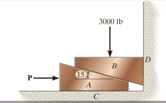

Provided the following diagram determine the reversed force of P needed to pull out the wedge, A.
Given the coefficient of static friction between A and C and between B and D is 0.2 and between A and B static friction is 0.1. Weights of wedges are neglected.
Force of friction = static coefficient * normal (When impending motion is occurring)
Let NC be the normal at C
ND be the normal at D
NB be the normal between wedge A and wedge B
FC be the friction force between wedge A and wall C
FB be the friction force between wedge A and wedge B
FD be the friction force between wedge B and wall D
For FBD of wedge A:
X-direction:
0 = 0.2 NC - NBsin15 - 0.1NBcos15 - P
simplifying 0= 0.2 NC - 0.3554NB - P (Equation 1)
Y-direction:
Nc - NBcos15 + 0.1NBcos15=0
simplifying Nc=0.94 NB (Equation 2)
For FBD of wedge B:[/B]
X-direction:
NB= ND/(sin15) (Equation 3)
Y-direction:
NBcos15 - 3000 + 0.2ND = 0 (Equation 4)
substituting equation 3 into 4 and solving ND = 763lb
From equation 3 then NB = 2947.9 lb
From Equation 2 NC = 2771lb
From Equation 1 P = 493.5 lb
My answer is considerably off the correct answer which is 106 lb

Isn't P supposed to be pulling the wedge out? That would mean that friction forces acting on wedge A are exerted toward the right.[/B]

This is why the question says the reverse force of P so -P. I accommodated for this in my equations. Sorry about the bold my bad

Equation 1 is not an equation. There's no " = " in it.
In the line before that there is no P, and shouldn't 0.1NBcos15° be to the right, so have " + " ?

Sorry I forgot to add that variable when typing the corrections have been made,

That doesn't address the sign on 0.1NBcos15° .
Sorry you are absolutely correct let me work through this with this change, thank you!
Excellent, Thank you so much for your time it worked out! Sorry for wasting your time on such a trivial mistake. I was looking at this for hours and didn't notice it.
