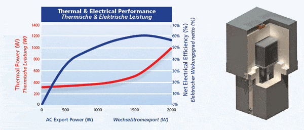

How does a fuel cell perform at part load?
GTEs are somewhat of a niche market right now, but one very good niche is sewage treatment plants, which use megawatts of electricity (to run massive pumps) and tons of heat (to keep their vats of crap warm) while producing lots of methane. Traditionally, they'd take grid power to run the pumps and capture some of the methane for heat (maybe 25-50%), flaring (burning off) the rest. A GTE can provide both the electricity and heating.
  • #59
mheslep;2599508I said:
can't find anything that exceeds 60%, and even that is only at a specific power operating point less than full load.
I believe that 60% is total power conversion, including transformers and/or converter. I have lots of info about SOFCs that can operate at those efficiencies, unfortunately none of it I can share on the internet. I'll try to find some other sources later.
You may be right about diesel and SOFC reliability being a wash, I really have no info about diesel generators but for SOFCs the only components that ever really need maintenance are pumps.
This Australian SOFC model reaches peak efficiency at about 80% rated load, falls off slightly at 100%, and falls off drastically at below ~40% load.
http://www.fuelcellmarkets.com/images/articles/443/graph.gif
It's not clear it this company is actually in production mode yet.
  • #62
Thanks. Put another way, at 25% ouptut, the efficiency drops by 40%. For the turbine I linked above, the efficiency drops by 30% at 25% load. The curves are not the same shape, though, and it looks like their curves cross somewhere around 10% load (ie, below 10%, the fuel cell isn't losing as much of its peak efficiency).
  • #63
