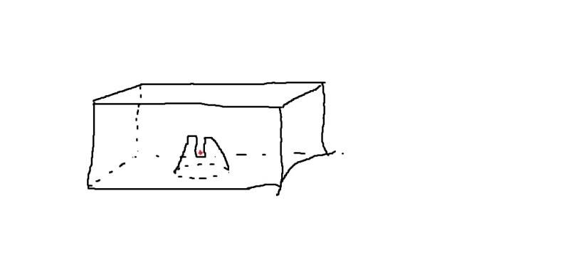

Hey there, just had a question about Gauss' law, should be relativity simple however the explanation we were given was quite poor and only seems to apply well to the examples we were given. (This isn't homework).
I (think I ) know the equation for Gauss' Law and what it means, that basically, the net flux through a gaussian surface multiplied by the Electric Field strength at the gaussian surface is equal to the total enclosed charge by the surface all over epsilon_o.
However I'm having problems intuitively with that;
If you had a shape like this;
http://i27.photobucket.com/albums/c171/Chewbacc0r/gauss.jpg
Surely at that point where the Gaussian surface, there's obviously so charge enclosed but is there really no electric field? The only explanation I can think of is by thinking that charge wouldn't be uniformly distributed locally at that point, as it's much closer together, so the charge around the surface would be weaker?
That's possible, but I've got a feeling I've just misinterpreted the law somehow, if anyone could help that'd be great.
Edit; imagine the little structure at the bottom is at the middle of the box.

I'm not sure I understand your sketch. The key point about Gauss' law is that there will be no NET flux out of a closed surface unless there is some net charge enclosed by the surface. You can have lots of flux and an E-field, but the flux in one side of the surface equals the flux going out of the other side of the enclosed surface, unless net charge is enclosed.

Yeah I understand that, i'll re-draw the sketch as best I can, basically it's a 3d box where in the middle there's some sort of structure protruding into the middle of the box, at the red point, sureley if the charge is evenly distributed around the whole shape the E field at the red point would be non-zero, come to think of it, in almost any non-spherical shape this would be the case.
My question is that is Gauss' law true that there is infact no E-field inside? And would this follow for the inside of any hollow 3d shape? ( providing the charge is distributed on the outside and non inside) Or am I interpreting it wrongly? - Maybe is it something to do with how the charge is re-distributed to make the E field inside 0?
I'm really struggling to picture this and any tips on picturing it would be great.

Gauss' law doesn't say that the field inside the volume will be zero. It says that the flux through the closed surface will be zero since there's no charge enclosed.

Hmmm, I think I see what you're getting at,
So all gauss' law tells us is the relationship between the next flux and the enclosed charge? Does that then mean that really unless some clever symmetry is used Gauss' law can't be used to find the electric field stregnth inside any hollow 3d shape?
Right.
Exactly! While Gauss' law always applies, it's only useful for finding the electric field in special situations that have high symmetry. For an arbitrary shape, it's useless.

I think I understand now;
My teacher whenever they showed an example he jumped straight from the integral to the EA = Qenclosed / E_o, taking it for granted every time, since he said he "didn't want to get into the integration."
But I think I understand now that it the reason is related to the integral;
[tex]\oint E.dA[/tex]
For the gaussian surface the Electric field is constant, for example in the sphere because the electric field is only dependant on distance from the centre, which is the same for the whole surface, and therefore can be taken out of the integral. To give EA = Qenclosed/Eo.
Whereas for a non-symmetrical example, such as the one above, by no means would it be constant, and you'd need the electrical field strength as a function of area or something else in order to evaluate it!
So is that right? Gauss' law can only be used where the electrical field strength is constant for the entire surface? - Or can at least be split up into numerous examples where that's the case?

You have it exactly right.
Here are the usual examples where Gauss' law can be used to find the field, since over the Gaussian surfaces used the electric field is constant (or zero): http://hyperphysics.phy-astr.gsu.edu/hbase/electric/gaulaw.html#c4"
