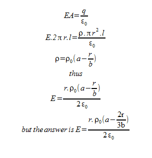

An infinitely long insulating cylinder of radius R has a volume charge density that varies with the radius as given by the following expression where ρ0, a, and b are positive constants and r is the distance from the axis of the cylinder.
Use Gauss's law to determine the magnitude of the electric field at the following radial distances. (Use the following as necessary: ε0, ρ0, a, b, r, and R.)
(a) r < R
(b) r > R
gauss's law

My unsuccessful solution:
lets take the length l,
for r<R,
why?
hi sicrayan! :smile:
no, you're taking the mass inside radius r as πr2 times ρ(r) …
it isn't, you need to integrate :wink:
