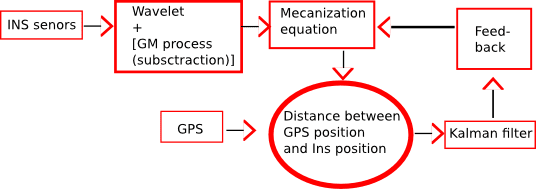

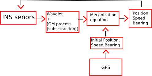

the system starts its loop after receiving the initiale position, bearing and speed from the GPS receiver.
this loop, presented in the first figure, is used during GPS outage.

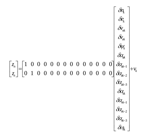

Now, when a new measure comes from a the GPS receiver, the distance between the GPS and INS positions will be used as input for the kalman filter.
the measurement equation, as in [1],is
I followed the same model as ([1]), except I used Gauss-Markov process instead of autoregression.

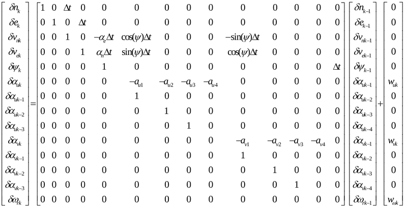

The vector in the right is called the error state vector. It is used to estime the INS error.
αuN and αvN are the parameters of the 4 ordre autoregression process for the 2 accelerometer axes.
If I have well understand, the use of the process parameters inside this matrix serve for the prediction step. it gives an estimation for the evolution of the error for the epoch t+(1/INS_frequency)
but after giving its feedback, the error state vector will reset to zeros
