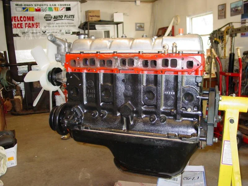

i am going to remove my diesel engine which weighs 800lbs and bolt it to an engine stand.
i will be using 4 hex bolts with dimensions, 3 1/4'' long, just over 1/2'' thick, 13 threads per inch, 1 1/4'' thread pitch, marking 8.8 on head.
i am trying to figure out if 4 of these bolts can hold the 800lb engine?
i assume this method of strength is shear strength??
can someone tell me what one of the above afformentioned hex bolt can hold ??

The way the typical engine stand works is that there are 4 bolt holes on one end of the engine block where the transmission is normally attached. A vertical plate on the stand is bolted to the engine block by 4 bolts into those holes and the engine is held only by it's attachment to the plate. So the length of the engine block is going to matter. The block is going to be like a cantilever beam, only supported at one end. (There should be plenty of exercises in mechanical engineering texts about such beams!) I think a long engine block will exert more tension on the bolts than a short one of the same weight.

Assuming your engine and engine stand are the same as for this http://forum.ih8mud.com/attachment.php?attachmentid=407438", then it appears the vertical bolt spacing is h1 = 164 mm, and it appears the distance from the bolts midpoint to the engine center of gravity (CG) is a1 = 360 mm (or less).
Using h1 = 164 mm, a1 = 360 mm, and yield factor of safety FSy = 1.70, it currently appears M12, property class 8.8 bolts will work, assuming you torque them to 42.0 N*m, and assuming you have a thread engagement length (Le) of at least 16 or 18 mm. However, please let us know if your h1, a1, and Le dimensions are different, because it can make a big difference in the stress results.
As saurya08 mentioned in post 9, what is the vertical spacing between your upper and lower bolts (h1)? And what is the horizontal distance from the bolts midpoint to the engine CG (a1)? Also, what is the upper bolt thread engagement length (Le) in the tapped holes? What is the tapped hole material? And are the threads of the upper tapped holes greased, or dry?
