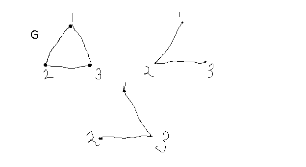

Wait, I might have found a counterexample.
Look at this graph G. Now the graph on the right is a spanning tree of G. The one on the bottom is acyclic, however it is not a subgraph of the one on the right. Are you sure you had to prove it was a subgraph of every spanning tree or a spanning tree?
Every spanning tree, I'm afraid. But isn't it a subgraph? Just not induced?

The graphs are isomorphic yes, but I don't think they are subgraphs of each other. So the assertion is false, since 2 is not true.

Of course, but the premise was "F is an acyclic graph which is a subgraph of G". The graph on the right satisfies this property, however it is not a subgraph of the graph below, but the graph below IS a spanning graph of G. Where did you get this problem by the way?
