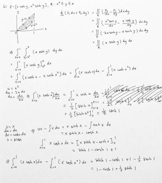

Question: Evaluate using Green's Theorem and sketch R.
The question (excluding the sketch) and the attempted solution are on the attached image. I may have gotten the solution, but the numbers seem funny. Where did I go wrong?
I don't see anything humorous in those numbers :tongue2:
Your work is correct.
Well, it's just that I seldom get something like sinh 1 or cosh 1. Anyway, thanks! :biggrin:
