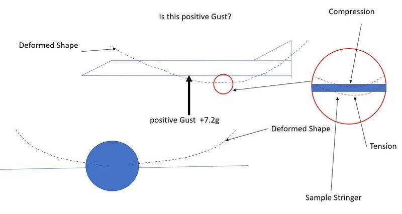

Thank you Lnewqban for your reply. To follow up on your question. I mean in FAA terms and lingo, when we talk about positive gust ( for example FAA says that we have +7.2g Gust (is this a positive Gust or Negative Gust)
1) In Case if this is called positive gust, what is the direction of the air flow of Gust is it : UP d or DOWN?
In Case if the answer is UP : Does that mean the a "FRONTAL" view of airplane makes smiling face?
In This case does that mean that the "SIDE" view of airplane makes smiling view as well?
Which means for any stringer on the belly of the airplane we have compression for inner flange and tension for outer flange if all the above is true then for negative gust (let's say -6.3g from FAA) everything is reversed it that correct?
I attached a picture to clarify more
Thank you in advance,
Cheers!

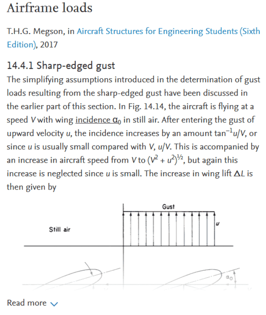

To my untrained eye, it looks like your diagram has the aircraft deflection response inverted. I used a Google search on Aircraft gust response or similar to find this article:
https://www.sciencedirect.com/topics/engineering/gust-load-factor
It looks like a positive gust results in more lift from the wings, which seems intuitive.
From FAR (Federal Air Regulation) 23.333(c)(1)(i): Positive (up) and negative (down) gusts of 50 f.p.s. at V C must be considered at altitudes...

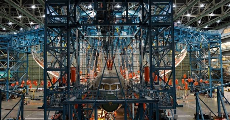

This assumes that the airplane is in straight and level flight, and right side up (no aerobatics). A positive gust pushes the airplane up. The wing tips bend upward when this happens. There is a famous photo on the internet showing a static test of the Boeing 787 wing simulating a positive load factor:
The wings bend up under positive loads. Counterintuitively, the horizontal tail bends in the opposite direction in order to get positive pitch stability.
Holy crapolski! If I were in a window seat (wearing my seatbelt) and looked out the window to see that, I would KMAGB!

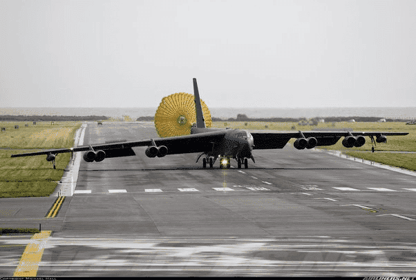

The B52's wings were so floppy they had training wheels.
Likes FactChecker
That particular B-52 is low on fuel. With full tanks, the wingtip wheels on both wings would be on the ground. B-52s wings are designed so that they generate lift when the fuselage is level with the ground. When they take off, the wings lift first, after which the rest of the airplane lifts off, after which the pilot rotates.
Likes Lnewqban
Yes, exactly right. You can see clearly in this video.
I was privileged to once experience takeoff in an airliner simultaneous with takeoff of a B52 on a parallel runway. It was the perfect vantage point to see the wing flex.

Thank you jrmichler for your reply. I get a hold of the book. As a follow up for a positive Gust (lets say what FAA defines as +7.2) meaning:
1) the gust wind air flow direction is UPWARD
2) Wing tips are going up (smiley face)
Now, are 1) and 2) correct?
If YES, Does this mean also that the nose and tail are going up resulting in fuselage making a smiley face as well:
if the above is correct, does that mean the inner flange ( the flange closer to the center of the fuselage) of a stringer at the lowest part of fuselage (at the belly) going through COMPRESSION, or I am wrong.
Mind you the last conclusion was based on previous stated (assumed) comments.
Thank you in advance and looking to more conversations.
Keep in mind that the force from the tail is not usually what people expect. To counteract the nose-down rotational force from the wing, the tail usually provides a downward aerodynamic force.
