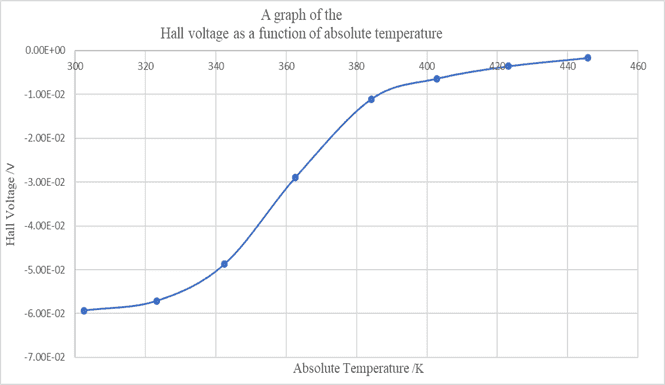

If a Hall effect magnetic sensor is designed to operate at 40°C, how much temperature variation would be tolerable for a Hall voltage accuracy of ±5% -I have I graph of hall voltage vs the absolute temperature but I am not sure how to go about this
Temperature Variation ?Accuracy?
I have I graph of hall voltage vs the absolute temperature and I know the Hall voltage value at 40°C but how to use this data
Then you know what an error range of ±5% from that looks like. What temperature range does that correspond to?
Ah I get it now , Thanks !
