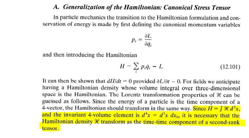

Hello all,
I am reading through the Jackson text as a hobby and have reached a question regarding the Hamiltonian transformation properties. I will paste the relevant section from the text below:
I don't understand what he's getting at in the sentence I highlighted.
To attempt to see what he is saying, I tried to show that by transforming the Hamiltonian density ##\mathcal {H} -> \mathcal {H'}## and multiplying it by the transformed 3-d volume element ##d'^3x##, the resulting Hamiltonian ##H'=\mathcal {H'}*d'^3x## is basically equivalent to the time component of the transformed four-momentum, but it did not equate (I used a simple case of constant velocity in the ##x## direction with ##E##&##B## fields in the ##y## and ##z## directions).
Could someone please provide some insight into this problem?
Thank you much

What you are integrating over is a 3-surface in 4-dimensional Minkowski space. Just as a 2-dimensional surface element ##d\vec S## in 3-dimensions is a vector quantity, you could view the 3-surface element in Minkowski space as a vector. In the case of ##d^3x## when integrating over a simultaneity, it should be pretty clear that the direction of that vector is in the time direction.
A more subtle point is the transformation of the Hamiltonian itself (not the Hamiltonian density). In general, when transforming from one inertial frame to another, it is not obvious that the total 4-momentum should satisfy the same transformation rules as the 4-momentum of a single particle. This is because the simultaneity surfaces in the new inertial frame are not the same as those in the original one and therefore the integration domain is different. Indeed, if there is any external 4-force-density acting on the field, the total 4-momenta of a time in ##S## and a time in ##S'## will generally be different (just as the total 4-momenta in either frame will generally change with time). However, in the absence of an external 4-force-density, the divergence theorem will essentially tell you that they indeed are the same 4-vector.More advanced notions (care only if you understand it): The 4-volume-form in Minkowski space is ##\eta = dx^0\wedge dx^1 \wedge dx^2 \wedge dx^3## and is a 4-form, i.e., it takes four 4-vector arguments. When you integrate over a 3-surface (e.g., a simultaneity) in Minkowski space, this 3-surface gives you three directions (given by ##x^1##, ##x^2##, and ##x^3## in the case of a simultaneity). To integrate, these three directions must be contracted with the 4-form, but since there are only three of them, the result of this is a 1-form that is orthogonal to all of these directions (since differential forms are completely anti-symmetric). The only remaining direction if you integrate over a simultaneity is the time direction. The general map from a 1-form to a 4-vector is a type (2,0) tensor and so the time-component of the result must be the 00 component of that type (2,0) tensor.
Thanks for the reply. Per your last paragraph, I guess it would be nice to see what you're saying explicitly written out mathematically. That would probably help me grasp the fundamental logic of what's going on...but since I haven't studied differential geometry yet, I imagine that's too difficult to do in this forum. Perhaps if you know of any good resources on this topic, please feel free to mention them.

Indeed. I guess what I was looking for with respect to my original question was a mathematical demonstration of what Jackson is trying to encapsulate in that paragraph using the regular "vanilla" calculus that he's exclusively worked with thus far in the book. I was hoping that was possible since (to my knowledge) he doesn't assume the machinery/nomenclature of differential geometry. Perhaps in this instance, though, my assumption is not correct..
The argument is essentially the argument I gave first in #2. Of course you could perhaps flesh it out by writing some additional formulas, but the basic idea remains the same - a map from a vector to a vector is a rank 2 tensor, the original vector is in the pure time-direction and you are interested in the time component of the resulting vector so what you are interested in is the time-time component of the rank 2 tensor.
