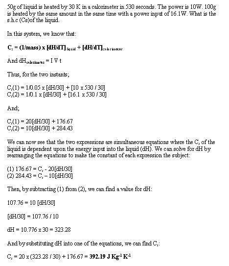

Here is the problem. 50g of liquid is heated by 30 degrees in a calorimeter in 530 seconds. The power is 10W. 100g is heated by the same amount in the same time with a power input of 16.1W. What is the s.h.c (Cs)of the liquid.
I know that:
Cs = (1/mass) x (dH/dt for liquid) + (dH/dt for calorimeter)
and thus I have a set of two simultaneous equations which can be solved for Cs.
I also know (well, I think I do) that dH/dt for the calorimeter is equal to the power input. The questions is, what is dH for the liquid? Am I barking up the right tree in the first place?

50g of liquid is heated by 30 K in a calorimeter in 530 seconds. The power is 10W. 100g is heated by the same amount in the same time with a power input of 16.1W. What is the s.h.c (Cs)of the liquid.
Made a mistake in original post - what I know is that:
Cs = (1/mass) x [dH/dT]liquid + [dH/dT]calorimeter
and dH for the calorimeter is IVt (power x time), So:
Cs(1) = 1/0.05 x [dH/30] + [10 x 530 / 30]
Cs(2) = 1/0.1 x [dH/30] + [16.1 x 530 / 30]
Cs(1) = 20[dH/30] + 176.67
Cs(2) = 10[dH/30] + 284.43
Rearranging:
(1) 176.67 = Cs - 20[dH/30]
(2) 284.43 = Cs – 10[dH/30]
Subtract (1) from (2):
107.76 = 10 [dH/30]
[dH/30] = 107.76 / 10
dH = 10.776 x 30 = 323.28 J
Substitute dH into one of the equations:
Cs = 20 x (323.28 / 30) + 176.67 = 392.19 J Kg-1 K-1
Does this look right. It seems low for a liquid unless it something like Mercury?

Well, I think you may be making this more complicated than it is.
I would recommend doing an energy balance and not worry about heat rate (dH/dt), in which case, one has the following general equation:
(energy into liquid) + (energy into calorimeter) = energy input = power * time
or mcs[itex]\Delta T[/itex] + Ecal = P * t.
In the first case one has
0.05 kg * cs * 30K + Ecal = 10 W * 530 s = 5300 J
and in the second, one has
0.10 kg * cs * 30K + Ecal = 16.1 W * 530 s = 8533 J.
Two equations and two variables. One can multiply the first by (-1) and add to second equation.
But wait.
What is the difference between the two cases? The mass of liquid and the power input. All the other parameters are the same.
The difference in power * time (same in both cases) = difference energy = 8533 J - 5300 J = 3233 J.
Where does that difference go? Into the difference between the masses (100 g - 50 g) = 50 g or 0.05 kg.
So the 3233 J = 0.05 kg * cs * 30 K or
cs = 3233 J / (0.05 kg * 30 K) = 2155.3 J/kg-K.
