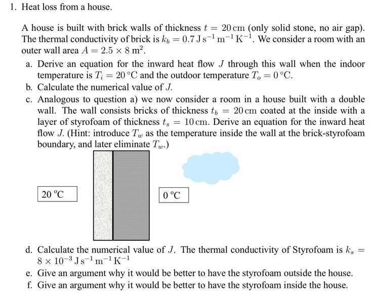

How can I eliminate Tw in the equation for heat loss from a house?
In summary, the student is trying to solve for Tw using two different Js and then combining them to eliminate the term.
Donna14
27
I'm struggling to understand question 1.C
How do I incorporate Tw and later eliminate this?
-k*A*(ΔT/ΔX)
For 1.a I used this equation: -k*A*((Tinside-Toutside)/thickness wall) I thought to put T inside first as they ask for the inward heat flow and that will be negative (heat loss)...
For 1.c I'm really stuck...
You get two heat flow equations, one for the styrofoam and one for the bricks. Using both together, you can elimitate Tw.
Thanks for your response.
Js=-ks*A*((Tinside-Tw)/thickness styrofoam)
Jb=-kb*A*((Tw-Toutside)/thickness brick wall)
How do I now eliminate Tw?
With the standard ways to manipulate equations.
Why did you use two different J?
I thought that I had two different J as they both represent a different number...
Im really not sure how to continue from here... I am sorry... Can you give me a hint?
J is the same for both because the heat goes through both walls in succession. The walls are in series.
Chet
Chet
But won't the flow through styrofoam be different from the flow through brick as they have a different k? And one Goes from inside to the brick wall and the other from the brick wall to outside.
I understand that there is also a 'total' flow from into outside.
And how do I combine these 2 equations. I might be very dumb, but really trying to see it!
This is very much analogous to an electric circuit with two unequal resistors in series. The overall voltage drop is analogous to the overall temperature difference, and the current is analogous to the heat flow. The current flow through each of the resistors is the same. The temperature at the interface between the styrofoam and the brick is analogous to the voltage in the wire between the two resistors. So:
I = ΔV1/R1
and
I = ΔV2/R2
ΔV=ΔV1+ΔV2=I (R1 + R2)
I = ΔV/(R1 + R2)
Chet
I = ΔV1/R1
and
I = ΔV2/R2
I = ΔV/(R1 + R2)
Chet
I really appreciate your effort!
I understand now that J is the same, but still don't know what to do with the to equations... Sorry!
Do the same thing we did here with the two voltage drops. Solve for the two temperature differences, and then add them to eliminate Tw.
Chet
Chet
I got it!
Thank you so much!
