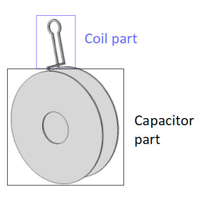

I'm not at all convinced . What are the actual construction details of this set up ? A clear sketch and some dimensions would help us a lot to understand the physics of this problem .
al1XxLW
http://imgur.com/al1XxLW [\IMG]
al1XxLW
Hello, here is a sketch of the setup.
wire is 0.025mm squared section with total length of about 3mm. in this 3mm you can see there is a 300° loop, which form a 0.25mm diameter coil.
Disks have 3.5mm diameter and one of them has 1mm diameter hole
This seems to be a very different problem to the one first described .
Never mind - the problem as given now is probably more interesting .
So the current pulse is definitely going to be powerful enough to cause the wire link to fuse and/or explode .
Your question then is effectively how much of the heat generated in the wire by the pulse gets transferred to the discs ?
Intuitively I would say not much .
To actually get a numerical answer though is going to be extremely difficult .
During the application of the current pulse the wire is going to be sequentially solid , molten and vaporised .
Heat transfer is going to take place during all these phases and with the additional complication of a continually changing configuration geometry as well .
May be easier to use limit state methods rather than detailed calculations to get initial answers .
The complete system could possibly be analysed using some advanced computer modelling software but it would require a lot of work .
Complete modelling using FEM software has been done.
Expansion due to magnetic forces macth quite good with measured expansion during the experiment. This is why I'm quite confident that the heat transferred to the discs is not negligible.
Anyway I would like to have some complete theory on this aspect, to have a solid explanation. I think a simplifyed model proposed at the beginning is more or less ok and also Chestermiller formulation sounds to be appropriate.
I already have numerical solution, I would like to understand if the concept of the two discs as reservior of temperature works from the conceptual point of view or not.
You say "intuitivly not much", can you explain me why?
