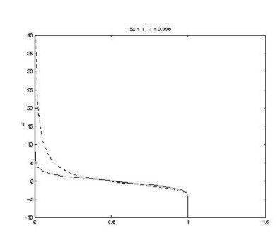

Not, the solution is not discountinous at all. Don't forget what is the origin of the problem. It cannot be a discontinuity anywhere.
Here is a plot of the solution F'/rho (solid line) and Y (dashed line). I hope you could see it.
Thanks Clausius. What value of [itex]\epsilon[/itex] did you use?
Also, what does the plot look like for [itex]\eta<0[/itex]?
Sorry, I missed your last post.
The value of \epsilon is 0.056. If you look at the vertical axis, there are also negative values of \eta computed.
