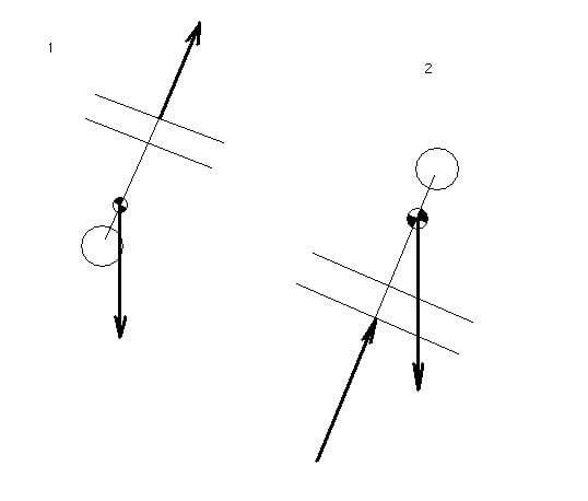

Given these two helicopter designs, which, if any, of them would be more stable?
(No image? 1 is propellers on top, body below, second is body above, propellers below)
Common sense tells that 1 would be more stable, but experience and rocket pendulum falacity shows that both are equally (un-)stable.
Is that really so?
Would the aerodynamics change something in it?
And, is there a proper (i.e. tell-anybody one) explanation why so?

To first approximation, the force of the blades for each model acts through the center of mass. In neither model is there either a restoring or a destabilizing torque that would either right it, or tip it over.
To this first approximation, neither has a restoring force that would right it from a perturbed orientation from the vertical. Without further details of how a rotor acts dynamically in air in relative motion or considering the gyroscopic forces, we haven't answered why one is more unstable than the other, or even if there is a difference in stability.
Assuming that the "body" of the contra-rotating rotor helicopter has a much lower drag to mass ratio than the rotors, then once the helicopter leans, it will start to "slip" downwards. The relatively higher drag to mass ratio of the rotors should cause a upwards pitch torque, and cause the helicopter to level out, if the "body" is below the rotors. (Some "tuning", like how far the body is below the rotors would be needed to prevent over-correction). If the "body" is above the rotors, you have an unstable condition that gets worse over time. There are small indoor twin rotor helis that are very stable in hover and seem to rely on this effect.

If CoM is located in the direction of applied force from CoP, the system is always unstable. The reason that a rocket is more stable with high CoM is because the low CoP of fins is more significant than low CoP of the engine, and force from fins points away from CoM. What you are actually fighting by raising CoM is the CoP of the fuselage drag, not the CoP of engine thrust.
Would it not make more sense to imagine the rotors in a stable hover in both cases and replace them with a solid surface. That way you have two pendulums in different positions - one incredibly stable (1), the other incredibly unstable (2).
if you break it down to just the lift force and the force of gravity, there is not much difference between the CG above or CG below scenarios. That is if you make the assumption that the rotor is rigid enough so that it's thrust vector is always coincident with the CG.
Since there are only forces acting on the aircraft, if any given force is coincident with the CG then the moment is zero. Moments can only be generated when a force is NOT coincident with the CG and therefore has a moment arm. Gravity, being one of the primary forces acting on the aircraft, always acts through the CG and therefore does not ever cause any moments and therefore does not cause rotation.
Forces acting coincident to the CG can only cause translational (linear) movement. Forces not coincident to the CG cause moments about the CG and therefore cause rotational movement as well as translational movement.
Only considering the two forces, Gravity and thrust (lift), we can see that no moments are ever generated. Because both forces are always coincident to the CG.
Since gravity is alway vertical and thrust is always oriented normal to the rotor, the two forces are only coincident when the orientaion is such that the rotor is perpendicular to gravity. So if the helicopter is not level there will be an unbalanced horizontal force causing translational movement. As the helicopter accelerates there is also F=ma that balances out any moments. These conditions are pretty similar whether upside down or right side up.
Basically both cases are neutral stability.
However, when we start considering aerodynamic forces, and a thrust vector not remaining coincident to the CG, everything changes and gets a lot more complicated...
Any displacement of the mass in 1 will result in gravity acting to return it to the start point, leaving you with a very stable design.
In number 2, any displacement of the mass will result in craft trying to turn itself over, a very unstable design.
The only way to ensure stability in number 2 is to have a variable pitch rotor system to compensate for movement of the mass. But any large movements and there's nothing you can do. This isn't a problem faced in number one because even large movements of the mass will still result in it trying to return to its original position.
As I said, think of it as an inverted pendulum.
A pendelum rights itself because gravity generates a moment about a hanging attachment point. That is not the case here, the thrust and weight forces do not generate a moment about the CG and therefore there will be no pendelum or righting effect.
The imbalance of forces indicated below will only cause translational acceleration, they will NOT cause any rotation because no moment is generated about the CG. For proof just watch the video in post #15

Uh, no. You are picturing this with a fixed pivot at point where force is applied. It's not fixed. The whole thing is free to move. The moment arm around the point where force is applied is irrelevant. What is the moment of gravitational force around center of mass? It's ALWAYS zero. So net torque is zero in both cases. You CANNOT think of this as a pendulum.
The problem is purely with the fact that realistically, the force from rotor will never pass exactly through center of mass. If it did, both designs would be equally stable. Even that in itself isn't sufficient to make one design more stable than the other. It's only when you add aerodynamic forces on the body that 2 becomes less stable than 1.
