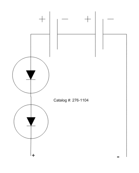

I just want to build something very simple/inexpensive/safe that will keep the voltage at 7.2V when the batteries are outputting > 7.2, and something that won't stop the batteries output when it's running low and is 7.2 or below.
Here's an example diagram that this E dummy can understand (I couldn't write it left to right as the editor strips the spaces) and you could always copy and paste.
If you have the Radio Shack codes for any items you suggest, i'd appreciate (I don't think I know of any other electronics stores here).
Using mugsby's idea, one diode would be sufficient to drop the voltage within range of 7.2V Remember a 1N4001 turns on between 0.65 to 0.7V. So a single diode would take the 8.0V down to 7.3-7.35V
But two diodes would take it down to 6.6-6.7V. (too low, target is 7.2V).
As the pack self-discharges within first couple of hours to a nominal 7.2V, the drop across even one diode becomes too low 6.5-6.55V. So I wouldn't recommend the diode approach.

seeing as most diodes test at .6v (never encountered .7 in the real world) and that he's get 8+ (lets assume 8.2 for lithiums as metakron states) then you have 7v (two diodes) and that's as good as it's going to get unless he uses a (complicated, expensive) dc-dc convertor.
edit: i don't think he wants to build this.

Being a little curious what exactly does this diode do (shack doesn't provide descriptions etc on it's website). Can you touch them in operation without a shock. Will they get hot. Could anything make them blow or melt.

A diode performs two basic useful functions. It's primary function is to rectify alternating current, to act as a switch that passes current only one way. The other is that it drops a fairly constant voltage in a series circuit. The second function wastes power in a rectifier, but it is often useful for various circuits.
One diode, maybe two, can be used to drop the voltage below 8 volts. There isn't any simple way to put together an automatic switch that cuts out the diode from the scheme. The best thing you can do is put in a manual switch that you could mark as "reserve." Place it across the diode so that it shorts out the diode when voltages get low.

If you can run a single diode in series from the battery to the camera and get the required voltage drop to make this work, that's a 10 cent solution and about as simple as it gets.

Radio Shack has a selection of rectifier diodes. I don't know how much current your camera uses, but to be on the safe side you might want to go with a 2.5 or 3 amp diode instead of a 1 amp. If you know that it uses less than 1 amp, you can go with the 1N4001 to 1N4007 types. Any cheap silicon rectifier rated at almost any voltage will work if it can handle enough current.
