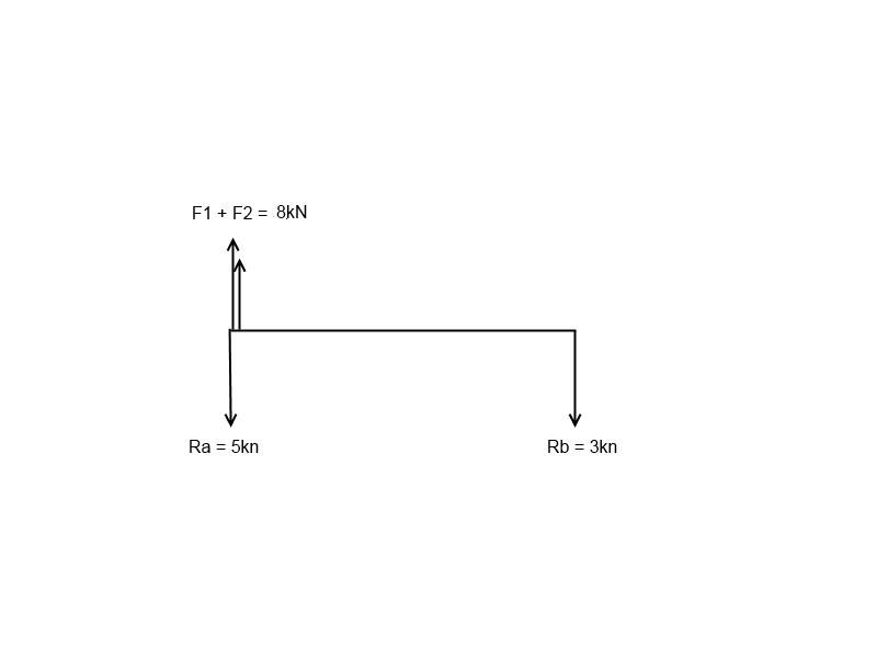

A shaft rotates at 1500rpm between 2 bearings, Ra and Rb. Ra force is 5 Kn and Rb is 3 Kn.
A single mass is to be used to balance the shaft, to give reactions of zero.
Mass to be placed at 90 degrees to shaft and at 200 mm radius.
What is the required mass and position?
I have done the following:
For equilibrium, the bearing reactions = 8 Kn so balance weight must be 8 Kn too. BUT, as the weight is non central (200 mm radius (and we can then assume shaft diameter at 400 mm)),
So, Ra = mass x position length / shaft length = 8 x position length / 200 x 1000 = 5 KN
Ra = 1000 / 8000 = 0.125
Ra = 8 x 0.125 / 0.2 x 1000 = 5 Kn
Then taking moments about Rb gives 3 Kn which is correct.
Knowing Ra = 5 Kn, Ra x 0.2m - 8 Kn x distance = 0 for equilibrium
So,
Ra x 0.2 m - 8 kn x unknown distance = 0
Ra = 8 x 125 / 200 x 1000 = 5 Kn
∴ mass should be 8 Kn 125 cm from Rb.
BUT, have I neglected the angular rotation wr? As the weight is 200 mm out from shaft centre?
And if so, then Mc Rc = mr
So I get Mc Rc = 8 Kn x 0.2 m = 1.6 Kg.
So final answer weight of 1.6 Kg should be placed at 200 mm radius (outer edge of shaft at 180 degrees to bearing reactions) at position 125 cm from Rb (bearing B of 3 Kn).

Your working looks wrong but I got same answer (1.62kg) using the equation for centripetal force..
F=mrω2=8kN
ω=1500rpm=157.1 rads/s
r=0.2m
solve for m.
I get a different answer for the position along the bar. It's clear the mass has to be nearer the end with the highest out of balance force (the Ra 5kn end) order to provide more counter balance force that end. Try summing the moments about the middle of the bar...

There are two parts to the problem..
1) Calculating the mass needed.
2) Working out it's position along the rod.
For part 1: The centripetal force of the new mass must be equal and opposite to the centripetal force caused by the out of balance shaft. You correctly calculated that this is 8000N. You know the speed and radius of the counterbalance so you can calculate the mass = 1.62kg.
For Part 2: You need to calculate where along the shaft the counter balance goes. See my diagram above..
Assume:
Rod is length 2m
Clockwise is +ve
X = distance from centre
Summing the moments around the middle of the rod gives...
-5*1 + 8*X + 3*1 = 0
-5 + 8*X + 3 = 0
8*X = 2
X = 0.25m
Likes 1 person
If you want you can sum the moments about the Ra end...
Assume Y = distance from Ra end..
3*2 - 8*Y = 0
6 - 8Y = 0
Y = 6/8 = 0.75m
or 0.25 from the middle. This is the same position as I calculated above.

Ok there are two conditions which I think have to be met..
1) F1 + F2 must sum to 8000N
2) The moments must sum to zero.
So first equation is... F1 + F2 = 8000 .....(1)
For the second condition take the moments about the middle and you get...
1*Rb + 0.5*F1 - 0.5*F2 - 1*Ra = 0
Rearrange that and you get
F1 - F2 = 2(Ra -Rb) = 6000 .... (2)
Now you have two equations and two unknowns.
Solving them gives
F1 = 6857N
F2 = 1143N
As a double check.. These add up to 8000N
Then using F = mrω2 on each gives
M1 = 2.78Kg
M2 = 0.46Kg

It's easy to prove that the masses must be positioned and split so the moments also to sum to zero...
Consider what happens if you put both masses very close to one end (for example at Ra)? The force they produce still sums to 8kN but the load on the Ra bearing will be 8000-5000 = 3000N.
Solving them gives
F1 = 6857N
F2 = 1143N
M1 = 2.78Kg
M2 = 0.46Kg
I was following this ok as a way of double checking my work, but surely for your equation 2, 2(Ra-Rb) = 2(5000 - 3000) = 4000 and not 6000 as quoted?
Good catch. Looks like I made an error. Should be...
F1 - F2 = 2(5000 - 3000) = 4000.
That gives new values of F1 = 6000N and F2 = 2000N and the masses will be different.
Thanks. Thought I was losing it there.
