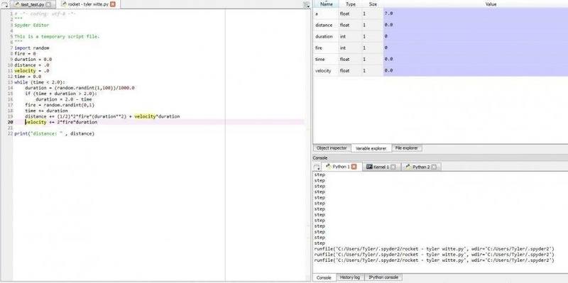

A rocket can either fire or not fire for a duration of 1-100ms with equal probability of firing/not firing. Determine how far it will go in the first 2 seconds of flight.
# -*- coding: utf-8 -*-
Spyder Editor
This is a temporary script file.
import random
fire = 0
duration = 0.0
distance = .0
velocity = .0
time = 0.0
while (time < 2.0):
...duration = (random.randint(1,100))/1000.0
...if (time + duration > 2.0):
...duration = 2.0 - time
...fire = random.randint(0,1)
...time += duration
...distance += (1/2)*2*fire*(duration**2) + velocity*duration
...velocity += 2*fire*duration
print("distance: " , distance)
4. Questions about this:
So one of my first questions is why is duration an integer? I've tried several things, putting decimal places in differently etc, to make it a float, but I can't seem to get it. I'm assuming it is changing types with the randint() function, but what should I use otherwise? Also, shouldn't dividing by 1000.0 change it to a float?
Also, I'm getting litterally nothing as an output, which makes me think it's getting caught in this loop here. I don't python much, or really code a whole lot anymore, so I'm probably pretty rusty and making noob mistakes. Is there something obvious in here that's not letting it leave the loop? I'll walk through my logic, in case it isn't obvious.

the variable 'a' in the console in the attached image is just a variable that I used to make sure that I could print like I thought I could. It worked. It's irrelevant to the rockets code.

Update:
It has to be my random. Literally none of my variables are changing as I step through this. I've tried 2 different random's at this point, I've tried randint(low,high) and randrange(low,high,step).
debugfile('C:/Users/Tyler/.spyder2/rocket - tyler witte.py', wdir='C:/Users/Tyler/.spyder2')
continue
continue
continue
continue
continue
continue
continue
continue
continue
continue
...x~50 more (removed for the absurd amount of continues)
continue
Even my duration isn't changing. I don't know what's up with this. Is there a better way to get random numbers? I know in java I used to use something to the effect of gettimemilliseconds(), and that would work perfect, but this isn't spitting out random numbers (unless literally about 200 in a row happened to be zero, which I find unlikely), and so it's getting stuck in the loop indefinitely.
Edit*
OK, I think I fibbed a little. I had to refresh my variable explorer each time. Fire is changing back and forth between 0 and 1, but duration is not at all.

+= and all of the other compound assignment operators are valid operators in Python. I noticed one line that might be causing problems for you
Python:
Python syntax doesn't use parentheses around the Boolean expression (unlike C and derived languages). Same for a while loop.
I haven't tested your code to see if the items I mentioned are problematic, so having the extra parentheses might not be the problem. Your duration variable should be integral, though, I believe, as the granularity of duration is supposed to be in (whole) milliseconds.
Some other things I noticed that may or may not be problems are that you initialized duration and velocity to .0, which at the very least looks odd to me.

Put a breakpoint inside your while loop, and see if the breakpoint ever gets hit. I suspect that the condition for your while loop is always false.
I wrote an Insights tutorial on how to use the built-in Python debugger (Pdb), if you're not sure how to do this.
Likes BiGyElLoWhAt
I did do that earlier, I actually put several. That's what all the "continue"s are up above. It got hit every time, so I think that for whatever reason, time wasn't increasing. When I would refresh my variable explorer or whatever it's called, duration was always equal to zero, while fire flipped back and forth between 0 and 1 like it should. I don't know why, though.
Here's your code with a few minor changes:
  • Removed extraneous parenthese on while header and if header
  • Removed (1/2) * 2 in calculation of distance
  • Change initializations of distance and velocity from .0 to 0.0
  • Added two print() calls to print value of duration - one of them before the if statement, and the other in the body of the if statement
Python:
import random
fire = 0
duration = 0.0
distance = 0.0
velocity = 0.0
time = 0.0
while time < 2.0:
   print("(1) duration: ", duration)
   if time + duration > 2.0:
      print("(2) duration: ", duration)
   time += duration
   distance += fire*(duration**2) + velocity*duration

I don't understand what your code is supposed to do, so I don't know how to correct it. The output above indicates that the condition for your if statement isn't satisfied for about 30 or so iterations of the while loop. From this I can infer that time + duration <= 2.0 until the next to last line of output above.
Likes BiGyElLoWhAt
That looks comparable to my output, minus all the duration prints. This code is only supposed to run until time= 2 seconds, and then it should terminate and print the distance traveled in that time.
I left the 1/2*2 in there because the acceleration was 2m/s^2 and the 1/2 is from integration. Just to make it a little more obvious to my prof that that's where that came from.
Like I said earlier, I don't know why, but my duration was sitting at zero, and if that doesn't change, then time can't increase. I don't know if there was a hiccup in my code somewhere causing this or what, but it's fixed now.
