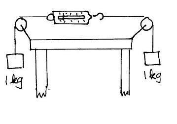

A spring balance is attached to 2 strings with hanging masses of 1 kg as shown . Assuming g = 10 m/s2 and the pulleys are frictionless, what is the reading on the spring balance, in Newton?
the attached file shows the diagram

Originally posted by ihat2
sorry this question as well

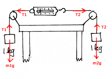

See attachment... each of the two masses are in equilibrium, since they are equal. Therefore [tex]T_1 = m_1g[/tex] and [tex]T_2 = m_2g[/tex]. Can you finish the problem? :smile:
and for the spring tension is the answer 10?
20N I would think, as each mass is 10kg so the gravitational force on each of them is 10N.
No, the tension in the strings is 10N. This is what the spring scale would measure.
