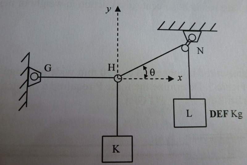

An assembly shown in the picture, GH , HK, HNL are three cables. the mass of box L is 52Kg,
a) determine the mass of box K in order to make angle theta as 25 degrees
FX=0
FY=0
right i started with
Fhn x cos(25) = Fhg x cos(0) as cos(o) is 1 i then wrote it out as
Fhn x cos(25) = Fhg
box L = 52Kg, i know HN = NL does the tension force NL= 52?
i know that when i get HN by looking at the forces acting on L & using Newtons 1st law to solve for NL i can calculate Fhg from the equation i started with. confused on how to get HN=NL thinks its 52.
then at joint H, the vert comp of HN must equal the tension in HK, per Newton 1st law in the y direction, and then i look at the forces acting on K to solve for its mass. i understand the theory I'm just confused about the calculations that need to be made, can anyone run through it with me please to find the mass of box K?

The 52kg block weighs 52x9.81N...this is the tension force in the string HN.
If you look at point H can you see that the horizontal component of the tension = tension in string HG and the vertical component of the tension must be the weight of block K
oh yes i forgot about the effect of gravity on the 52Kg block.
ok i understand to a point about the mass of block k , so would the mass of block k be HN x (cos25+sin25) ? then divide by gravitational constant to get the Kg value ?
You only need to consider the vertical component of the tension (510Sin25) to find the weight of block K
oh yeah i see now why its only the vertical component, so just 510xsin25=215.5 that's all?
That is the WEIGHT...I think you have to find the mass (easy?)
yeah just divide by 9.81 i believe ?
that's it !
brilliant thanks for your help! :)
