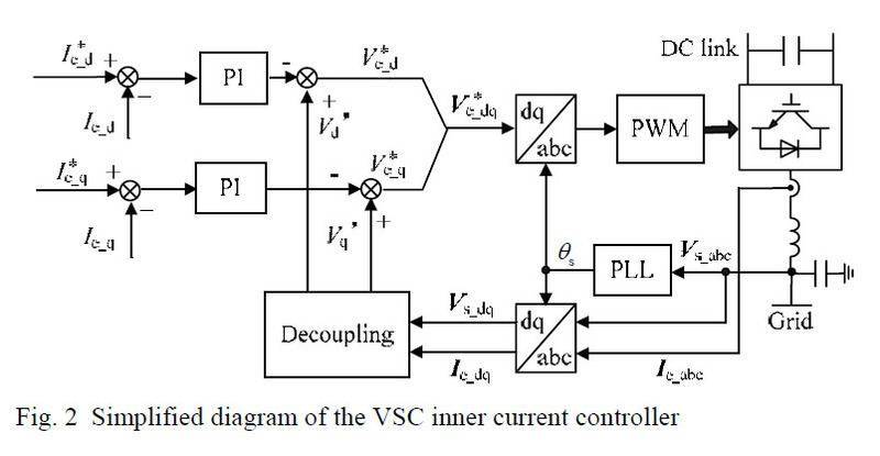

The VSC-HVDC instantaneous power control is typically based on current vector control. For the vector control using grid voltage orientation, the active power and reactive power are proportional to the d-axis and q-axis currents respectively. Although VSC terminals can have different operation modes, their inner control loops are similar, e.g., using the converter current PI regulator to follow the relevant current references.
What are "d-axis" and "q-axis" currents?

Shorthand for "Direct" and "Quadrature", ie in phase or 90 degrees out of phase with the rotating field. One carries the actual power, ie megawatts, the other carries the reactive power ie megavars.
You might search for a tutorial on alternators. TI's Motor Compendium is one I often suggest but it's a 12 meg pdf file,,, google finds it quickly... there are shorter ones around.
