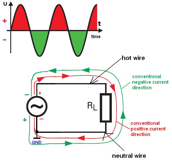

The HPF is formed by the input capacitor and the parallel combination of the base biasing resistors. The instantaneous polarity of the input signal does not come into play...
http://macao.communications.museum/images/exhibits/2_16_3_1_eng.png
Likes Grim Arrow
Why would input signal polarity change the filter type ?? Is it not the output voltage always taken across the resistor for HPF ??

Using the sample schematic I posted above, can you describe why the input polarity would matter?
The output voltage for HPF is always the voltage across the resistor no matter what input voltage polarity is.
And the AC signal polarity change the current direction only (and the output voltage polarity ), but we still have a output across resistor.
Likes Grim Arrow

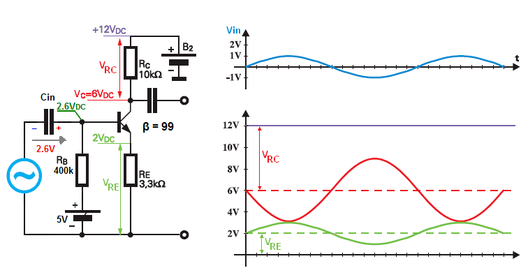

Maybe this will help you.
Let us see how the AC input current flow in CE amplifier supply from a single supply.
First we bias the BJT in the "linear region" via RB, RE resistors and 5V voltage source to be able to amplifier any AC voltage.
Vc = 6V (red plot ); Ve = 2V (green plot) ; Vinput = 1V (blue plot)
The DC voltage at base is equal Vb = 2.6V, and emitter DC voltage is 2V (Ie ≈ 600μA; Ib = 6μA).
Our AC source "produces" 2 peak to peak voltage.
And this AC input voltage will "modulate" the voltage at our transistor in the "rhythm" of a AC input signal.
The base voltage will change from 3.6V to 1.6V in "rhythm" of a AC signal.
These changes will result that the emitter voltage will also change. From 3V to 1V. This will result the change in emitter and in collector current by (3V) 0.9mA to 0.3mA (1V).

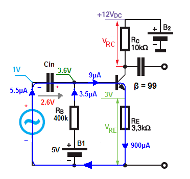

But what path the AC current flow ? Let us see:
For positive half-cycle (+1V peak) we have this situation:
As you can see 5V source provide 3.5μA of current, but the base needed to be equal to 9μA, so this additional current will come from the AC signal source. As I show in the diagram.

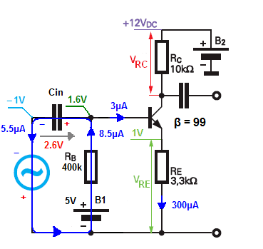

For Negative half-cycle situations looks like this:
As you can see this time the base need only 3μA, but our 5V bias source provide 8.5μA. This implies that our AC signal source need to "sink" this excess current 5.5μA.
Also notice that the Rin = Vin/Iin = (1V - (-1V))/(5.5μA - (-5.5μA)) = 2V/11μA ≈ 180kΩ which is true because Rin ≈ RB||(β+1)*RE ≈ 400kΩ||330kΩ ≈ 180kΩ
I encourage you to carefully analyze this.
Likes berkeman and Grim Arrow
Can't believe it. Can't believe how blind I was.. Offcourse. I mean, I know this, I was just blinded somehow. Too much thought in your head can make you dumb enough to not see the truth. It is just an ordinary HPF!
