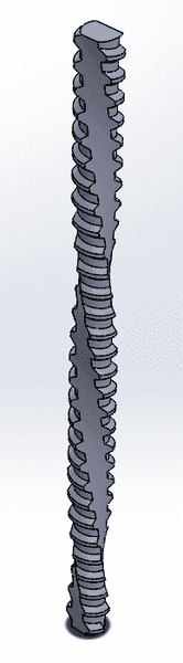

I need to make a system like this where the threaded rods extends but want it to rotate through 360deg (preferably only once) as it extends. is there a way to achieve this by modifying a hills hoist or am I on the wrong track completely?
If you replaced the lead screw with one something like this:
It'd rotate once per full height extension. Though, that'd be very difficult/expensive to make.
If you give us details of what you're trying to do we may have better suggestions.
