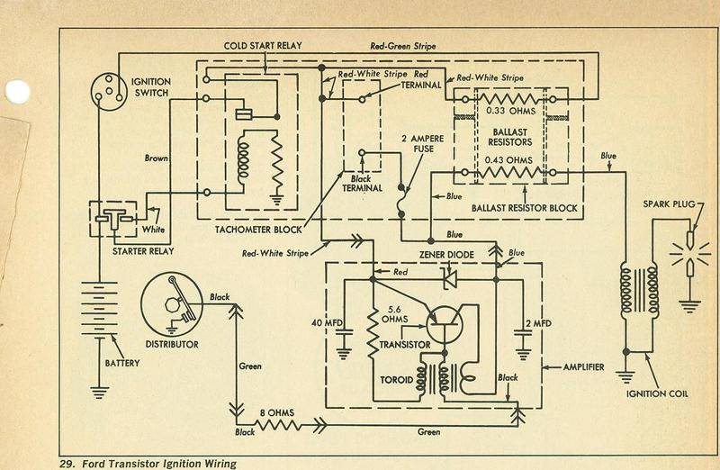

i agree ..check amp meter..Ford had a good idea by using a separate solenoid switch. 12 volt cable ran from + side of battery to the switch. another HD cable ran from the other big lug bolt to the starter motor. The switch was controlled by a smaller red green stripe 12 gauge wire running to one of the small terminals. Take a test light and check to see you got power on one side of the large lugs..if battery is ok you should. disconnect one of the smaller wires and with ignition key on, one of the wires should be hot...if not..you fried a wire..take a jumper wire and jump from hot side of battery to one of the the small terminal lugs..this switches on the solenoid relay and the starter should crank..

Ranger Mike,
None of the small wires on the solenoid are hot...so I have burnt a wire or fuseable link.
But I have not checked the wires going into and behind the fuse box.
Do you know how to remove the fuse box (on a '68 Mustang besides very carefully)? Are there bolts, clips, pop-rivets or whatever...
By solenoid I assume you mean the relay mounted on or next to the fender. None of the wires there should be hot except the main lug that is hooked to the battery cable. One of the wires activates the starter relay and the other is a ballast resistor bypass for the points style ignition. The heavy wire going to the starter itself should be obvious. There should be one or more wires hooked to the terminal that is the main battery cable. These are the wires you are interested in. It should end up at the ammeter. Now have you done like I asked and started at the ammeter?
hopefully you both read my post...i said with the ignition key ON..check for hot wire...
specifically..the ignition switch as an On setting..radio will play..and a turn and hold position that will throw juice to the starter relay...this is the ON I am talking about..rig the tset light so you can check the wire to the relay as you are holding the ig key at the above position..should be a hot wire and there had better be one ifin you expect the solenoid/relay to work...to see if it functioning.. use a jumper wire...nuff said?

I am not really that good a reading complicated electrical schematics. Could you walk me threw the step by step process of what happens (the power path) in the ignition system from the time the key is turned "on" (in the cylinder) to when the engine starts cranks.
There are two smaller wires on the starter relay correct? One of them is to activate the relay to run the starter. Obviously you won't have power there until you turn the ignition switch to START. The other smaller wire is an ignition ballast resistor bypass. When the starter relay kicks in the ballast resistor is bypassed for easier starting. Ignore this wire also, it is irrelevant at this point in troubleshooting. The issue is that you don't have power at the ammeter. Although I can't quite understand why you would have power at the oil pressure gauge. You are sure you were probing the correct place? I don't know the exact path of current between the ammeter and the starter relay main battery post but I am assuming that there is a burnt off wire or opened fuse link between the starter relay and ammeter. I doubt it goes through any fuse since charging current has to go through the ammeter and at times this is quite high. Vehicles of this age didn't place fuses in this location. Also, some systems use a shunt resistor out under the hood as part of the ammeter circuit. I don't think Fords of this age did, but I could be wrong. I am probably correct in assuming you don't have power at the heavy wire on the alternator either?
Edit: If there is no actual ballast resistor for the points style ignition then the actual wire between the ignition switch and coil is a higher resistance wire that serves as a ballast resistor. My '65 Galaxy is this way. Also, the diagrams that Ranger Mike has posted are simplified in that they do not even show an ammeter.
Doesn't the entire car's electrical system 12+ supply other than the starter pass through the ammeter shunt?
If so, it's path would need to be restored and the ammeter replaced.

Averagesupernova pretty well nailed it..and yes, the diagram i posted does not show an amp meter. And it soinds like you did smoke the wire on the amp meter.. let us concentrate on basic automotive trouble shooting...you have 12 volts at the battery..this has been confirmed. I was taught to always work from power out backwards to power in. Di you use a jumper wire from the hot side of the battery to the starter terminal lug of the starter solenoid / relay?
