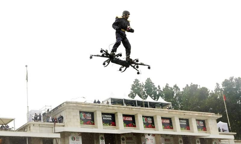

Here you go. The soccer ball is optional:
http://ftw.usatoday.com/2017/05/por...drone-match-ball-video-officials-green-goblin

80 HP worth of electric motor is quite a bit larger and heavier than the pictured hoverboard, and that's not considering several hundred pounds of battery required to supply it for a reasonable length of time. It isn't something you'll be able to tuck under one arm.
