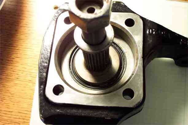

The bearing plate will be mounted inside a dodge caravan steering knuckle. The plate will provide a thrust surface to sandwich a 3-piece roller bearing assembly and the drive shaft’s machined surface.
The reason for such a bizarre arrangement is that I am converting my front wheel drive to a rear wheel drive and the front wheels have about .030 play since the drive shafts are no longer connected to the transaxle.
The basic idea is to install a thrust bearing so the detached/standalone driveshaft has something to press against when the hub nut is tightened down.

Yes, the bearing assembly will be housed inside the steering knuckle;
in-between the machined surface of the driveshaft and the bearing plate I am trying to design (see the attached images of the shafts and the steering knuckle).

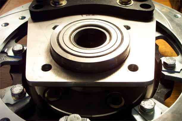

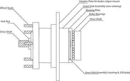

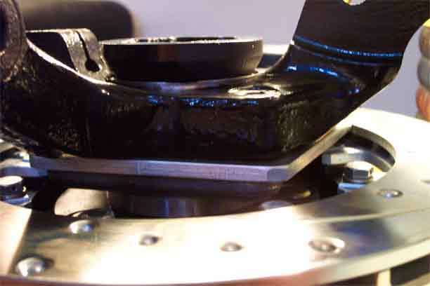

I have included more pictures and a drawing of the whole assembly (minus some parts for clarity).
Photo 1: Steering Knuckle
The knuckle mounts on the ball joint stud that is attached to the lower control arm. Also attaches the tie-rod end which is part of the steering linkage. The knuckle pivots on the ball joint as the steering linkage asserts input from the steering wheel.
Photo 2: Drive Shaft inserted indo Steering Knuckle
The Hub Nut is torqued to 180 ft-lbs. Note the machined surface on the drive shaft – this will be used as a surface for the roller thrust bearing.
Photo 3: Hub Assembly press fit into an adapter plate which holds the brake caliper
Note the outer surface of the hub assembly does not rotate. However, the inner surface does. In fact this is the surface that has the 0.030 lateral play that I am trying to constrain from moving back-and-forth. Also note the bearing plate will sit on top of this assembly resting on the non-rotating outer surface of the hub.
see next post for more photos and drawing

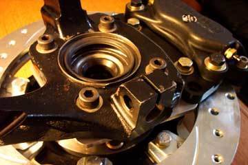

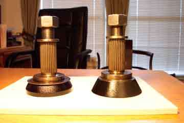

cont. previous post
Continuation,
Photo 4: Steering Knuckle without drive shaft mounted onto brake caliper adapter plate
Note the 0.325 space between the hub assembly and the bottom of the lubrication seal. This is the space the roller bearing assembly and bearing plate will need to fit into.
Photo 5: Drive Shaft inserted into Steering Knuckle – side view
Just for perspective
Drawing: The whole assembly
Regards,
Tony….

Q_Goest,
I have enclosed a cross sectional view in the prior posting (good idea, thanks).
You are correct in the assumption that the hub nut is what bears down on the thrust plate and bearing. I don’t have a thread gauge but I measured the thread diameter to be 0.845 inches and counted 17 threads per inch.

When the nut is tightened to 180 ft lb of torque, you'll get roughly 15,000 pounds of force pulling on the driveshaft. From the pictures, it would look as if that force is compressing this stainless washer you're putting in. It looks like the drive shaft is pressing against a thrust bearing which is pressing against this washer, which is pressing against the outer hub assembly. Is that correct?
Is the thrust bearing fully contained and have it's own races? I'd assume it does but it almost looks like the balls of this bearing are riding on this washer as you've drawn it.
The stresses seem way too high in this washer if the above is true, but I can't be sure without knowing what the thrust bearing OD and ID is. If the OD of the thrust bearing (where it bears on the washer) is at least 2.880" then it might be alright (that diameter almost eliminates any bending in the plate*) but you'll need the 17-4ph steel and preferably a hardened version of it. But then if the race is not properly supported, it will be damaged anyway, so that's probably not a good design. This plate seems to be supporting the race on the bearing, so it needs to be relatively thick. Can you make the plate thicker? (say at least 0.250", preferably more) You might be able to machine down the drive shaft to add some thickness for the plate. It looks like the drive shaft has quite a bit of added meat there.
*I used Roark's case 1, table 11.2 for this.
