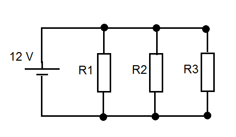

Apply Ohm's law and the nature of parallel circuits to determine the total current in a parallel circuit with three resistors: 3Ω, 6Ω, and 9Ω, respectively. The total voltage in the circuit is 12V. Explain your reasoning.
[/B]
Ohm's Law
[/B]
I tried to plug the values into Ohm's law, but I don't think that is how I am supposed to go about this.
I am not asking for someone to give me the answer outright, just a place to start here!
All answers will be appreciated! :wink:
It is necessary to show your working. Did you calculate their equivalent resistance first or did you directly apply Ohm's law? Both ways work fine.

Hi,
I just tried to apply Ohm's Law directly. I realized it wasn't going to work, because I have more values than are in that formula. But here is as far as I got.
First I added up all of the Ohms and got 18Ω. Then, I plugged it into the formula,
V/R = 12/18 = 0.6666666667
And I guess that could be right, I just figured that because of how I went about adding up the Ohms that it wasn't.
Thanks!

I think I have figured it out, using the formula for total resistance.
= 3x6x9/3+6+9 = 162/8 = 9
Then I used the formula for total current:
12/9= 1.33333333333333

No. The equivalent resistance of parallel combination of 3Ω, 6Ω and 9Ω is not 9Ω.
The formula in your image is true for only two resistors in parallel.

Oops I think I used the wrong formula. Here is the formula for multiple resistors:
Which would make 18, correct?
So then 12/18 is 0.666666667.

No. Equivalent resistance of resistances in parallel is less than the least of them.
Thank you for trying to assist me with this, and sorry if I don't seem to be understanding this. Could you tell me what formula is supposed to be used here then if it wasn't the one I used above?
Well, the formula in your above post is correct but it doesn't give 18 ohm. Try again using that formula.
What does 1/Rn stand for/mean though? Because all of the values I have are the resistors and the voltage...

I will give you a couple of hints.
One. For resistors in parallel the resistance of the combined resistors is less than the smallest resistor.
Two. The smallest resistor is 3 ohms. The current through that resistor at 12 volts is 4 amps.
Therefor the parallel resistance of all the resistors is less than 3 ohms, and the combined current will be greater than 4 amps.

You do not need the formula for the equivalent resistance. All resistors are connected directly to the terminals of the battery. What is the voltage across each resistor? Apply Ohm's law to calculate the current flowing through resistors R1, R2, R3, then add them up.

Instead of hunting for the right equation, try understanding the situation. This is what you'll be tested on.
In a parallel circuit, each item has the same voltage across it. Use that, and ##V=IR## to find the answers.
Just to clarify... both approaches work. You can either work out the equivalent resistance and then the current OR calculate the individual currents and add them up.
I encourage you to do it both ways to prove it to yourself that the answers are the same.
Likes ehild
The formula for the equivalent resistance follows from Ohm's Law, and from the fact that the voltage is the same U across each parallel resistors. So the individual currents are I1=U/R1, I2=U/R2,I3 =U/R3 ... The net current flowing out from the battery is the sum of all currents, I=I1+I2+I3 = U/R1+U/R2+U/R3. Pull out U : I=U(1/R1+1/R2+1/R3) The expression in the parentheses is the reciprocal of equivalent resistance for the parallel resistors.
1/Rp = ∑1/Ri, and I=U/Rp.
