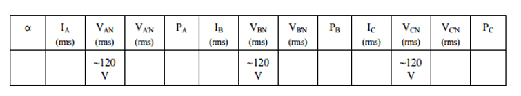

I need to calculate the power given the RMS values for voltage and current.
208 V line to line was put into the system. I measured the following data:

I believe the VA and IA values are the RMS values for voltage and current. I was given that VAN (rms) is about 120 (V) which is what was measured for the VA magnitude.
I need to fill out the table shown below.
α, VA'N, VB'N and VC'N can be ignored, I have the values for those columns.
PA = VA*IA
Ptotal = PA + PB + PC
This is what I think the answer is for each column and how I got it
IA = 12.1 (A) from measured data
VAN = 119.9 (V) from measured data
PA = VA*IA = 119.9*12.1 = 1450.79 (w)
IB = 12.2 (A) from measured data
VBN = 119.5 (V) from measured data
PB = VB*IB = 119.5*12.2 = 1457.9 (w)
IC = 12 (A) from measured data
VCN = 119.2 from measured data
PC = 1430.4 (w)
Therefore, Ptotal = PA + PB + PC = 1450.79 + 1457.9 + 1430.4 = 4339.09 (w)
Can you think of a reason why the phase angles of the each value might be important?

This is so similar to your earlier thread that you could have continued in that same thread. The formula for 3 phase power remains the same.
