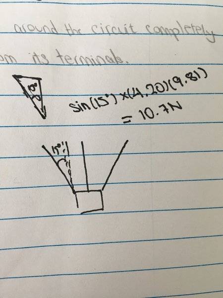

Well this is what I did... First because an angle was given so you need to use sine. And then the tension is always the weight of the object attached to the end of the rope so... Not sure, hope to get some pros to reply haha...
CrzCz said:
(img)
So what exactly did you do?
I understand as far as it looks like you did:
F = m•a
F = 4.2•9.8
4.3 for the mass and 9.8 for gravity? In which case why isn't it negative? (When gravity is supposed to be negative or not in a calculation always confuses me.)
F = 41.16
but why do you multiply that times the angle relative to vertical?
41.16•sin(15°) = 10.65
Also, whatever the answer is, will the tension be the same in each rope? Or different in the vertical rope as opposed to the 2 ropes that are on an angle?

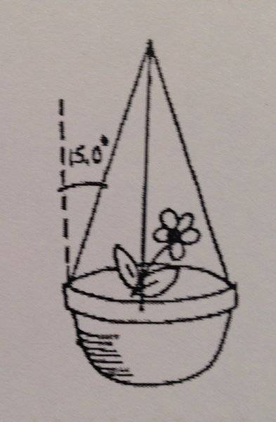

For clarification, the question includes this picture:
(I hope the picture can be seen properly.)
Edit: I cannot figure out how to upload a picture/make a picture (saved on my own computer) to show/be in my post.
In any case, the given picture has the two slanted roped connecting to the same center point at the top with the vertical rope.

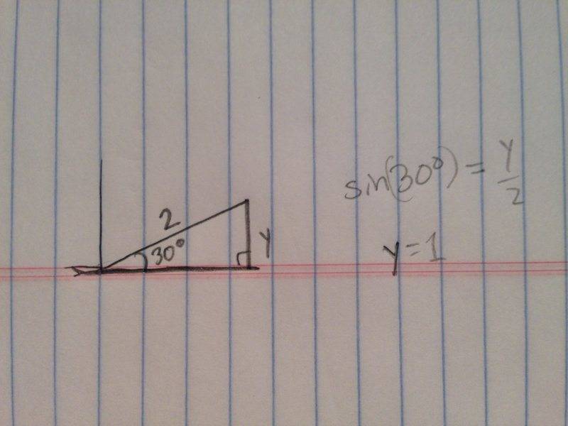

Do you understand what is meant by a component of a vector? If a vector has magnitude 2 and points up and to the right of the origin, at an angle of 30 degrees to the X axis, can you say what is its component in the Y direction?
I'm not exactly sure what is meant by a component of a vector. That confuses me because it sounds like it should be just one side of the triangle (when drawing it), but it is not actually that?
Would the y component be 1?
Right.
So back to the rope. The rope exerts a pull T at angle 15 degrees from vertical. What is the vertical component of the pull?
By the way, here is the flowerpot diagram given.

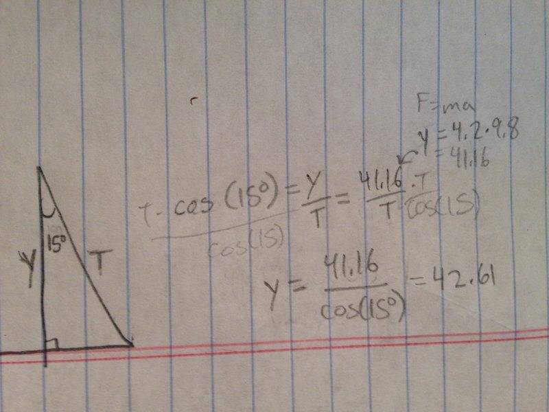

So if the vertical component is how much force from the flowerpot/gravity
F = m•a
y = 4.2•9.8
y = 41.16
then to find the tension, geometry
cos(15°) = y / T
cos(15°) = 41.16 / T
T = 41.16/cos(15°)
T = 42.61
Is this correct?
(My work on paper)
cos(15°) = y / T
Yes! Or to put it the way I asked the question, the vertical component of T is T cos(15°).
y = 4.2•9.8
Yes, except that now you have forgotten to divide by three.
Okay, so would my final answer be
T = total tension
T/3
42.61/3
tension in each rope = 14.2N
