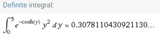

I am looking for a solution of the following integral
$$\int_{-\infty }^{\infty }\!{y}^{k}{{\rm e}^{-{\frac {u_{{0}} \, {{\rm e}^{-y}}}{a_{{0}}}}-{\frac {u_{{1}} \, {{\rm e}^{y}}}{a_{{1}}}}}}\,{\rm d}y$$
with ## 0<a_{0}##, ## 0<a_{1}##, ## 0<c_{0}##, ## 0<c_{1}## and ##k = 1, 2, 3, ..., ##.
Now that we are offf the unanswered threads list anyway:
I find it hard to believe an analytical answer exists.

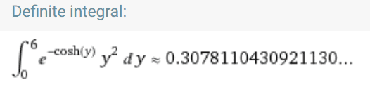

Doodled with ##\ u_0=a_0 \ \ \& \ \ u_1 = a_1\ ## so the integral becomes
$$ \int y^k\; e^{ -\cosh y} $$ and all the odd ##k## yield zero. What remains is interesting enough:
Wolframalpha does the work: for ##k=2## the bounds -4, 4 are already wide enough for 6 digits (0.615622) and of course 0, 5 gives the same result (but more digits !?):

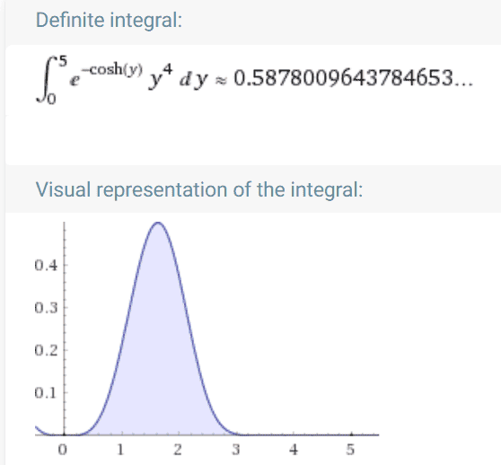

with ##k=4##:
(don't trust all digits, though:
and so on
But: with larger ##k## things become slippery:
