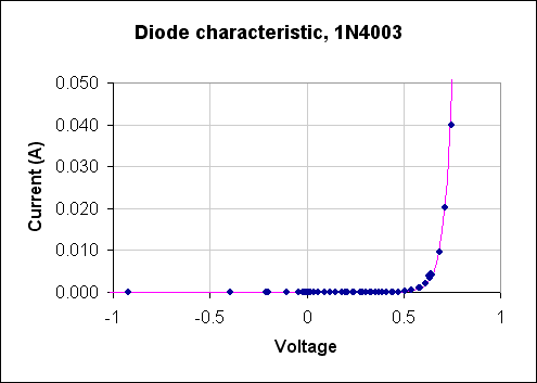

A few years ago I measured current vs. voltage for a common silicon diode:
The blue dots are my measurements, the magenta line is a curve fit to the data.
The behavior follows an exponential growth curve quite well, from 1 nA up to 1A. The current grows by factor of 10 for every 0.10V increase in this range.
At -1V, the current is -1.5 nA, which can be considered to be zero in most applications.
Extra credit Quiz Question for OP Cspeed -- what is the "diode equation", and why does it support Redbelly's data?
I(Diode)=I(saturation) * (e^qV/NkT - 1) seems to be the diode equation. Looking that up gave me some good insight. I would like to know about how diodes work, but at the same time I just want to get my generator working. I was hoping to build a bridge rectifier, which I had hoped would just convert x V AC to x V DC, but I'm seeing some info that makes me think that a diode will eat up .7 V (which is the forward voltage of silicon diodes).
