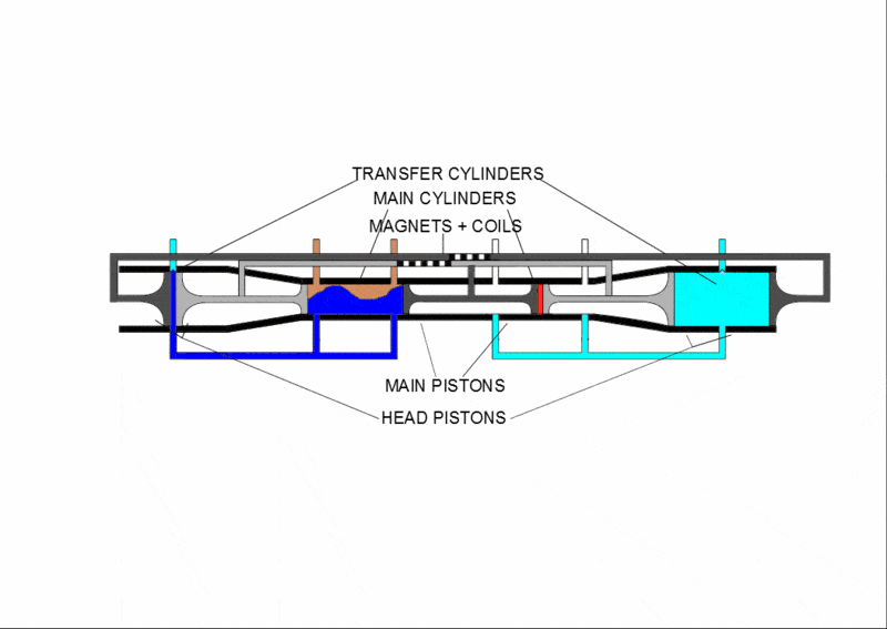

Hi,
Have you ever tried to invent anything?
Long ago, as a school boy after learning about internal combusion engines, I 'invented' a rotary engine. (It had actually been invented in the 19th century) My dad said "If Fords can't do then you can't" So I stopped. Years later I learned about the Wankel engine, which was similar to what I had thought, and carried on trying. I didn't mention it to my dad again.
I went through lots of iterations, and tried to get any interest, but gave up some time ago, and put it out of my mind.
The last iteration, was for an IC engine battery charger for hybrid vehicles, which didn't drive the wheels, had no flywheel and could infinitely change the compression ratio.
Here is the idea (animation), which I stress is not in anyway a drawing, but just to illustrate how it would work. I hope you find it interesting.
KEY: Light blue incoming gas--dark blue compressed gas--red combustion--brown exhaust.
Cheers, Camerart.

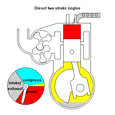

That is basically a 2-cylinder 2-stroke engine with the crankcase replaced by your "head pistons".
You may need some valves, either on the intake or exhaust side of your "main pistons" to regulate the flow (similar to a supercharged 2-stroke as presented below).
Likes berkeman
If you look a little closer you will see that this design has variable compression ratio, also there are valves on the intakes.
