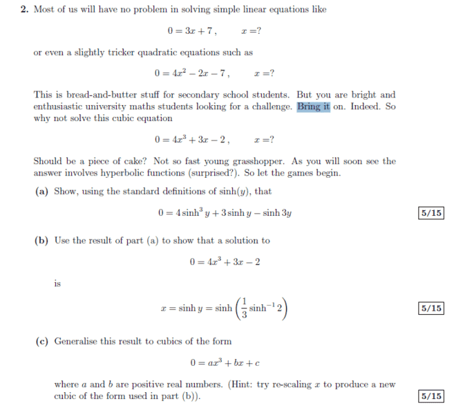

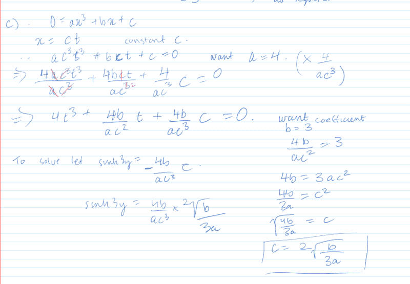

I don't think so.orbsoner said:[am i going about it the right way for question C).
