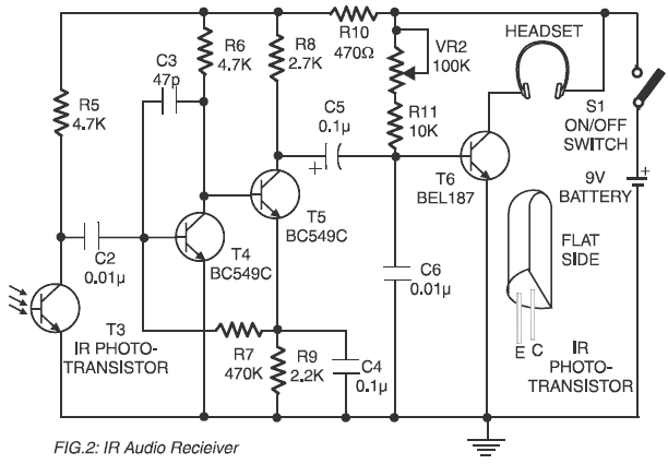

i am trying to do the circuit "www.electronicsforu.com/efylinux/circuit/.../aug99_IRcordless.pdf"[/URL]
the phototransistor showed in the circuit has only 2 leads but the 1 i brought has 3 leads with a number 1838 written on the top..
please help me what to do. even if i brought a new 2 lead phototransistor, how to find the emitter and collector?
also please help me with the audio output transformer. I am not getting it anywhere in the shops

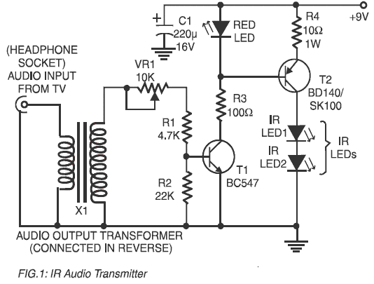

this is the reciever circuit.
and here is the transmitter
In the transmitter circuit, T1 base appears to fed with a relatively large audio signal without any added DC bias. I believe that this is likely to give a grossly distorted result - are you certain that this has been drawn correctly?
