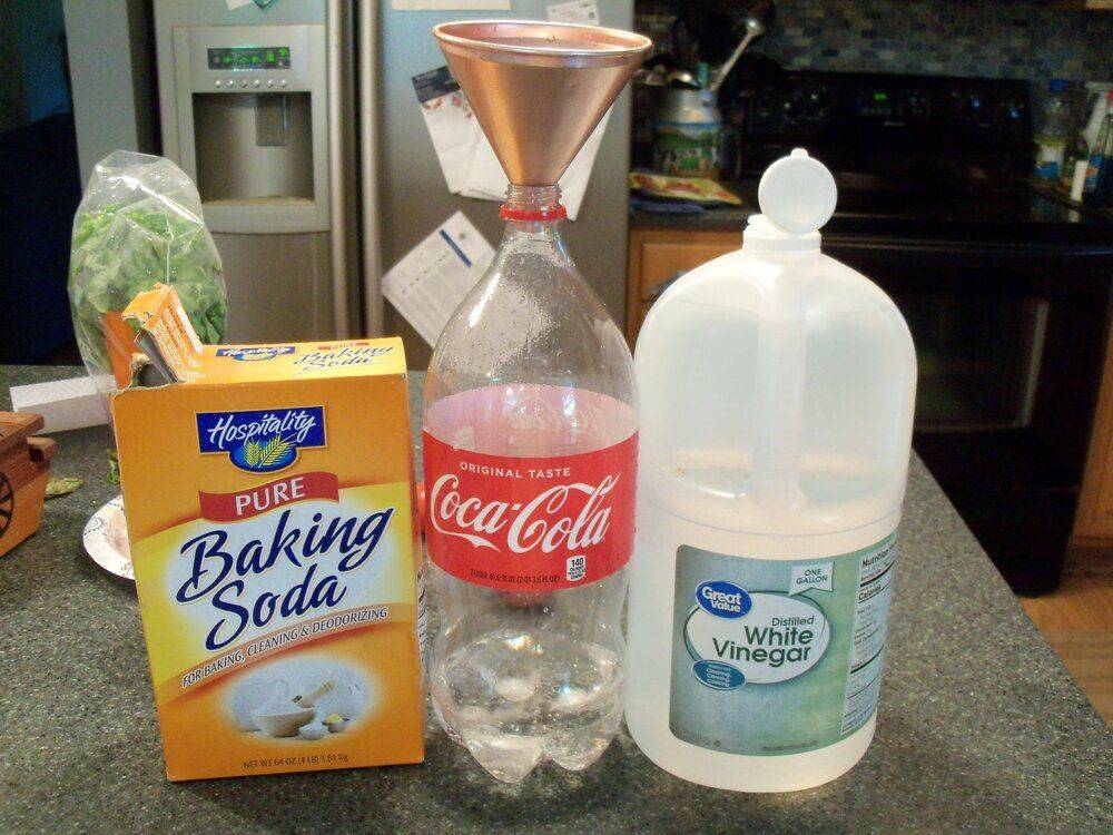

I took chemistry in high school & college 50 years ago. I don't remember how to do chemistry math? If someone knows the answer to my question it will be much easier than for me to figure it out BUT I would like to know how it is done I love technology. I took engineering in college.
vinegar + baking soda = CO2
Vinegar is 95% water and 5% acetic acid = CH3COOH
Baking soda = Sodium Bicarbonate = Sodium hydrogen carbonate = NaHCO3
Question #1, how much NaHCO3 is mixed with CH3COOH to be the perfect mixture to release all the gas?
Just from my experiments it appears I need about 5 times more vinegar than baking soda to release all the gas.
Formula should be something like this, 1 gram of NaHCO3 + 5 grams of CH3COOH = ? amount of C02

My vinegar is 5% acetic acid. I have to use a lot more vinegar to use up all the baking soda.

I did an experiment. I figured vinegar would have surface tension because it is 95% water but it has no surface tension. Compared to alcohol there appears to be no difference in surface tension. 5% acetic acid is reducing surface tension or water.
I put 1 teaspoon of baking soda in a clear glass container.
The first 5 teaspoons of vinegar that was added produces very violent foam = CO2. Each teaspoon of vinegar produces less and less foam = CO2. Teaspoon 11, 12, 13, 14, I have to stir the mixture to release more CO2 and the amount of CO2 that is releases is extremely small. After 14 teaspoons of vinegar I tasted the mixture it still has a slight baking soda flavor. 15 teaspoons extremely small noticeable CO2 is released. I tasted the mixture with 15 teaspoons of vinegar it has almost no flavor it is very close to neutral. I have PH paper I could have tested it but this is close enough for me.
I am making CO2. There is such an extremely small amount of CO2 produced after 10 teaspoons of vinegar I think the other 5 teaspoons are wasted vinegar. Those 5 teaspoons 11 to 15 will be more efficient to produce many times more CO2 by mixing them to a new teaspoon of baking soda. It is logical the small release of CO2 for teaspoon 11 to 15 is because vinegar is only 5% acid. If I were to use 40% acid I will probably see a higher amount of CO2 released and only need about 1.9 teaspoons of acid to do the job.
Vinegar is about $2.50 per gallon and baking soda is about $2.50 for 3.5 lbs. I could do math to learn how much 1 teaspoon of baking soda costs and how much 1 teaspoon of vinegar cost but I can see it is not cost effective to add 5 more teaspoons after teaspoon #10 the extra cost of vinegar out weights the amount of CO2 produced. A stronger acid or different acid and lower price acid my prove different results.
