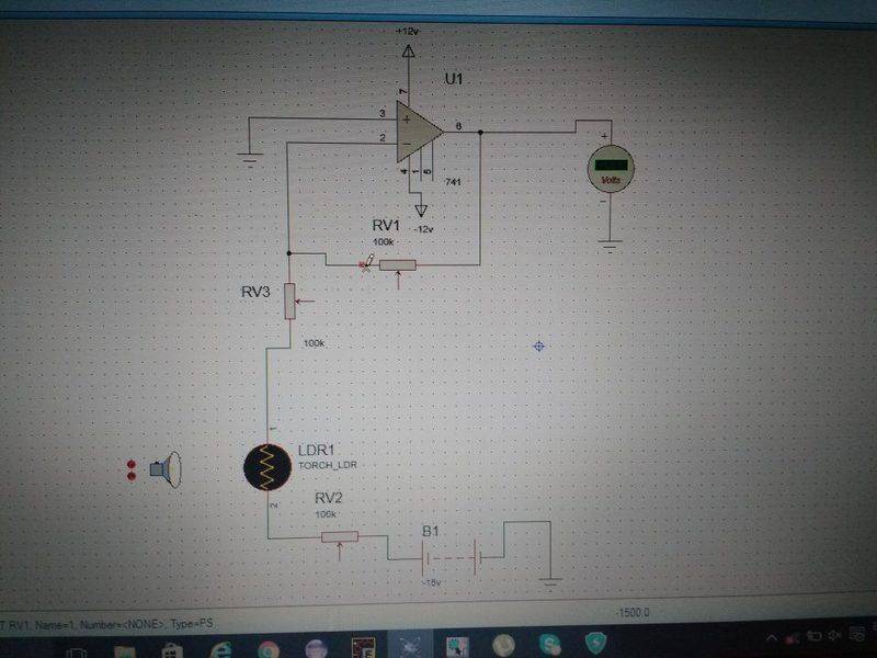

Please find the circuit attached above

The circuit schematic you posted does not use a photodiode...

Well i used an ldristead of photodiode to illustrate that, since my simulator didnt have the phtodiode

That's a completely different circuit than the one you were asking about. Just find an example circuit using Google Images and post that instead so we can discuss it. :smile:

You are welcome, but you didn't answer my question. I understand that the language translation issue is a problem, but we should still be able to help you if you would ask a clear question based on that simplified schematic. :smile:

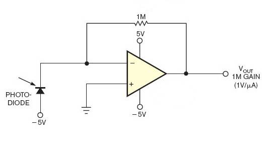

You can also use the schematic berkeman posted with an LED however the output will likely be lower than a purpose built photodiode. Single supply operation is possible if you apply an appropriate voltage to the non-inverting input.

Well,my issue was the current entering into the the inverting terminal of opamp exceeding the specified limit, but later on found out that most of the current went thro the feedback R , and the current entering invl was only nano amps
For voltage feedback op amps you don't want to rely on the exact value of the input bias current as this is a parasitic. You want to design your circuit so that the bias current is either insignificant or you compensate for it somehow.
That's correct, you have discovered a main rule of Op-Amp circuits
In an ideal/near idea situation no current flows into or out of the inputs of an op-amp
