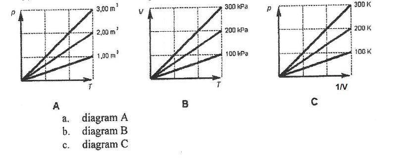

Hi guys,
Can someone explain me please how to find the following question?
Which diagram represents the behavior of an ideal gas the most?
I know it's C but I don't know why. They all seem to represent the behavior of a ideal gas.
But why C mor than the others?
Thanks
What is the equation that relates P, V and T for an ideal gas?
What is the relationship between P and T if V is constant (first graph)?
What is the relationship between V and T if P is constant (second graph)?
What is the relationship between P and 1/V if T is constant (third graph)?
P.V = n.R.T
==>T instead of V is constant here no(same values on x-axis)?
P.V = n.R. = constant so this should be wrong because there is a slope
isn't here also T constant instead of P?
V = n.R /P
So if V rises than P has to decline
This graph would not be possible because T is constant and P and V both rise.What is the relationship between P and 1/V if T is constant (third graph)?
Volume here is constant(same values on x-axis)
P= n.R.T (So if P rises T has to Rise too)
In this case they both rise so it would also be possible

You don't need the .'s. Just: PV = nRT
No. P is on the y-axis and T is on the x axis. Each line represents the points (P,T) for which V has the same value (that value is stated at the end of the line).
No. V is on the y-axis and T is on the x axis. Each line represents the points (V,T) for which P has the same value (that value is stated at the end of the line).
No. P is on the y-axis and 1/V is on the x axis. Each line represents the points (P,1/V) for which T has the same value (that value is stated at the end of the line).

Can you explain why c) is the correct answer (and why a) and b) do not fit: PV=nRT?)
AM
P(1/V)= nRT 1/V (function P with respect to 1/V)
So here nRT represents the slope of the graph
A larger Temperature gives a larger slope, which is what diagram C shows
So diagram C is correct.
P(T) = nR/V T(function P with respect to T)
So nR/V represents the slope of the graph
A Larger volume should give smaller slope, but in diagram A, larger V gives larger slope.
So diagram A is wrong.
V(T) = nR/P T(function V with respect to T)
So nR/P represents the slope of the graph
A Larger Pressure should give a smaller slope, but in diagram B, larger Pressure gives a larger slope.
Thus diagram B is wrong.
Am I correct?
Am I correct?
Yes. Very well explained.
